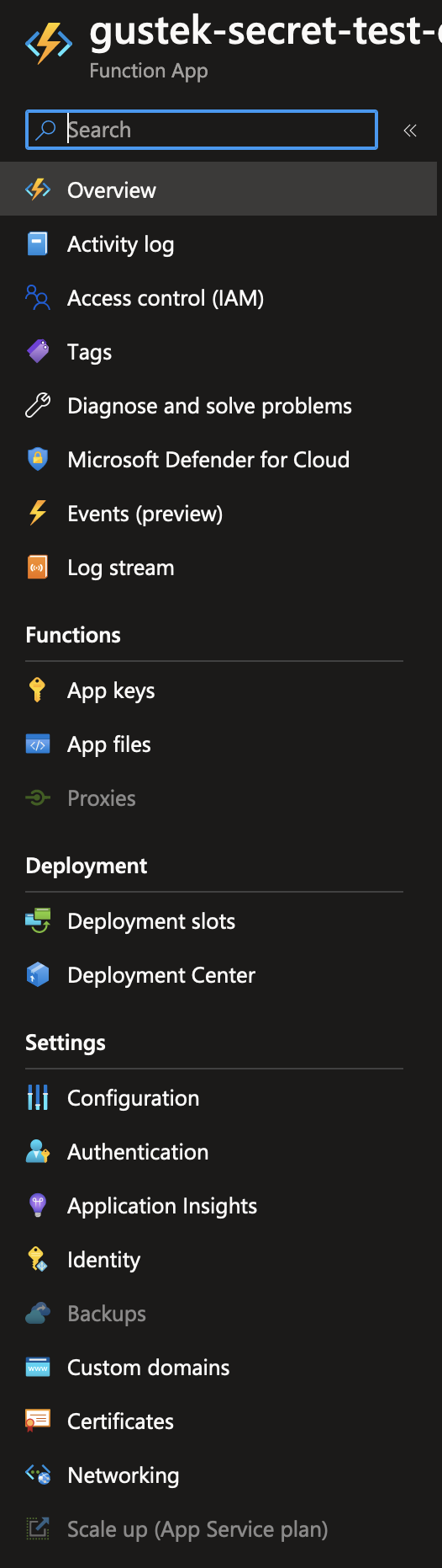

    Hi @Andrzej G , this looks like it is due to the cold start of your Azure Function. During a cold start, the Azure Function runtime needs to initialize the environment and load the necessary dependencies, which can take some time.
    In your case, it looks like the delay is caused by the ManagedIdentityCredential trying to obtain a token from Azure AD. This delay can be reduced by enabling the App Service Authentication feature in your Azure Function app. This feature allows your function app to use the same authentication settings as your App Service plan, which can help reduce the time it takes to obtain a token. Try enabling it by following these steps:
    1. Go to your Azure Function app in the Azure portal.
    2. Click on "Authentication / Authorization" under the "Platform features" section.
    3. Turn on the "App Service Authentication" toggle.
    4. Choose the appropriate authentication provider for your scenario (e.g. Azure Active Directory).
    5. Configure the authentication provider settings as needed.
    6. Save your changes.
    Please let me know if you have any questions and I can help you further.
