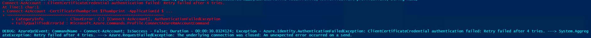

Hi, I'm working on migrating our VM management scripts (locally) from our current server (Win2012) to a new one (Win2016). To manage company's subscriptions & resources, PowerShell needs to establish a connection to Azure, we use a certificate based authentication / SPN, this is where the issue lies. PowerShell fails to connect using Connect-AZaccount cmdlet: Azure-Conn-Failure-AzureSupport
Debug: Connect-Azure debug
The self-signed certificate I've created for the new server was installed & tested on current one, it works fine. The new server is behind a firewall & a proxy, so no access to standard internet, only a few ports are open , AZ modules were copied manually from current one to it. PowerShell v5.1 | Az.accounts v2.2.5 | Ping login.microsoftonline.com -> success Could you please share any ideas that might help solve this issue? I'm open to any suggestion and/or further testing. Feel free to let me know should more details be provided. Thanks in advance! Mounir

    Update: The traffic was not opened to Azure, it was getting dropped at firewall level. The issue was solved after hooking up the server with the correct proxy configuration. Regards
