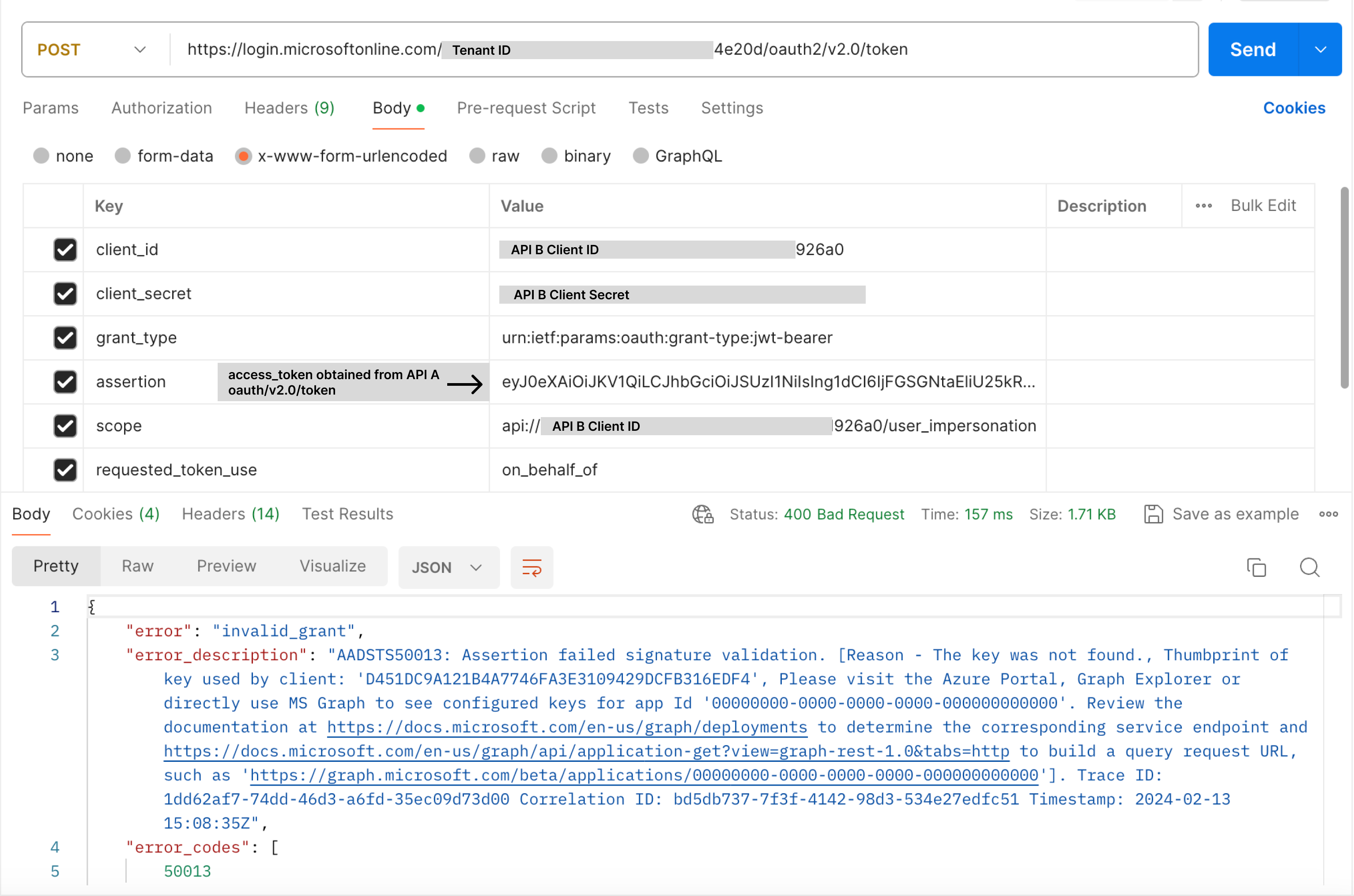

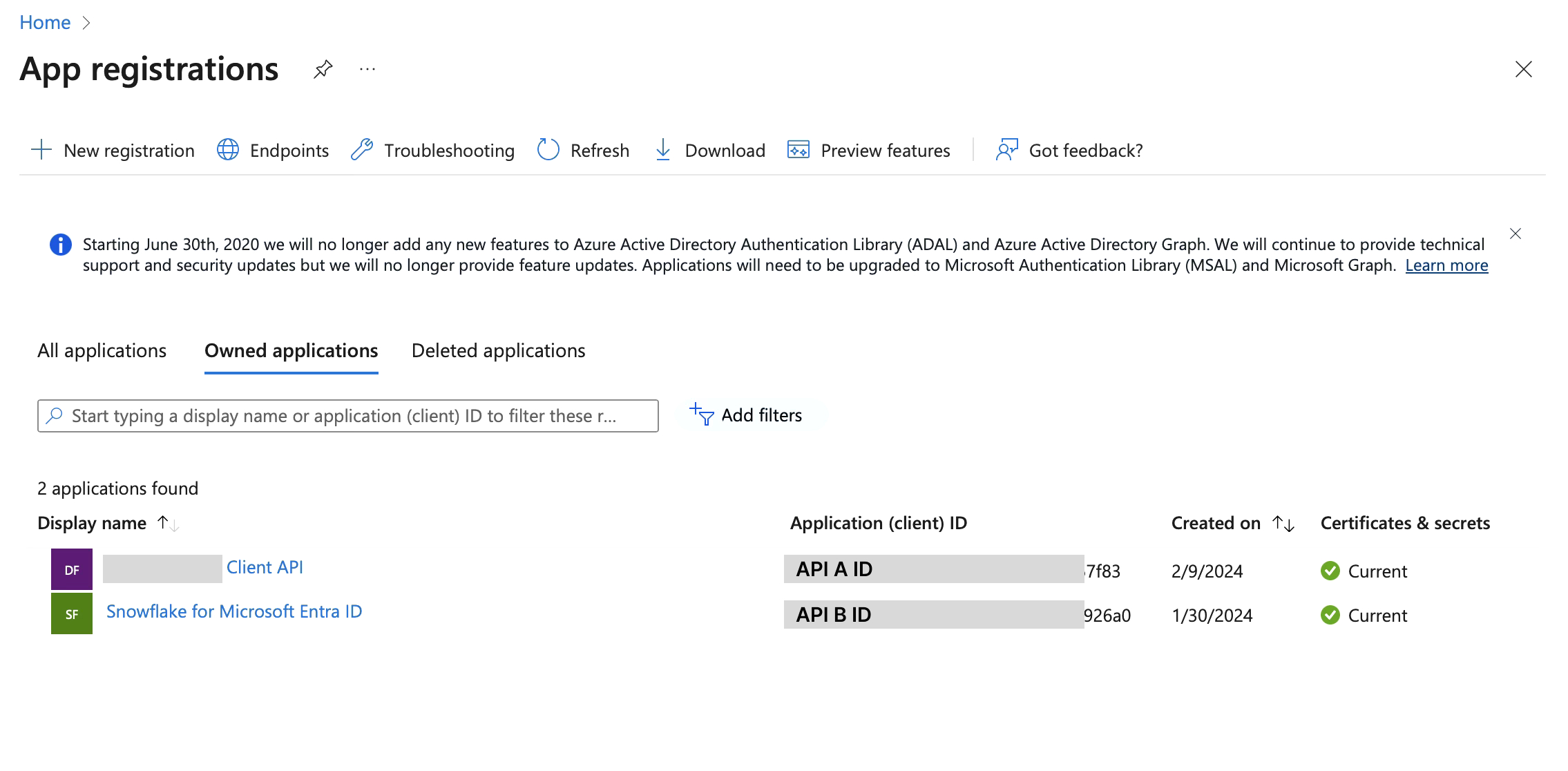

I am trying to implement the On-Behalf-Of flow so that I can make requests from a PHP web API to load data from a Snowflake database. I have been stuck on this error message for days now, and I am running out of things to try. I will include as much detail as I can here, so please bear with me. I have 2 APIs registered in Entra; a client API and an API that lets a user connect to a Snowflake database. I will follow the OBO documentation and call the client one API A, and the data one API B. app-reg
In API B, I configured a scope access_as_user and authorized the client for this scope. expose-api
Under Token Configuration for API B I added Optional Claims for acct, acrs, aud, and upn. I also created a new Client Secret under Certificates and Secrets for API B. Then, for the client API A, I added the previously created scope from API B to the API Permissions: Screenshot 2024-02-10 at 7.33.00 AM
I also created a new Client Secret for API A. I am able to complete the authorization code grant flow as shown in the docs here by calling /authorize in a web browser, logging in with my Microsoft credentials, taking the code from the response, and redeeming it for an access token by calling /token in Postman, like so: Token-A-Request

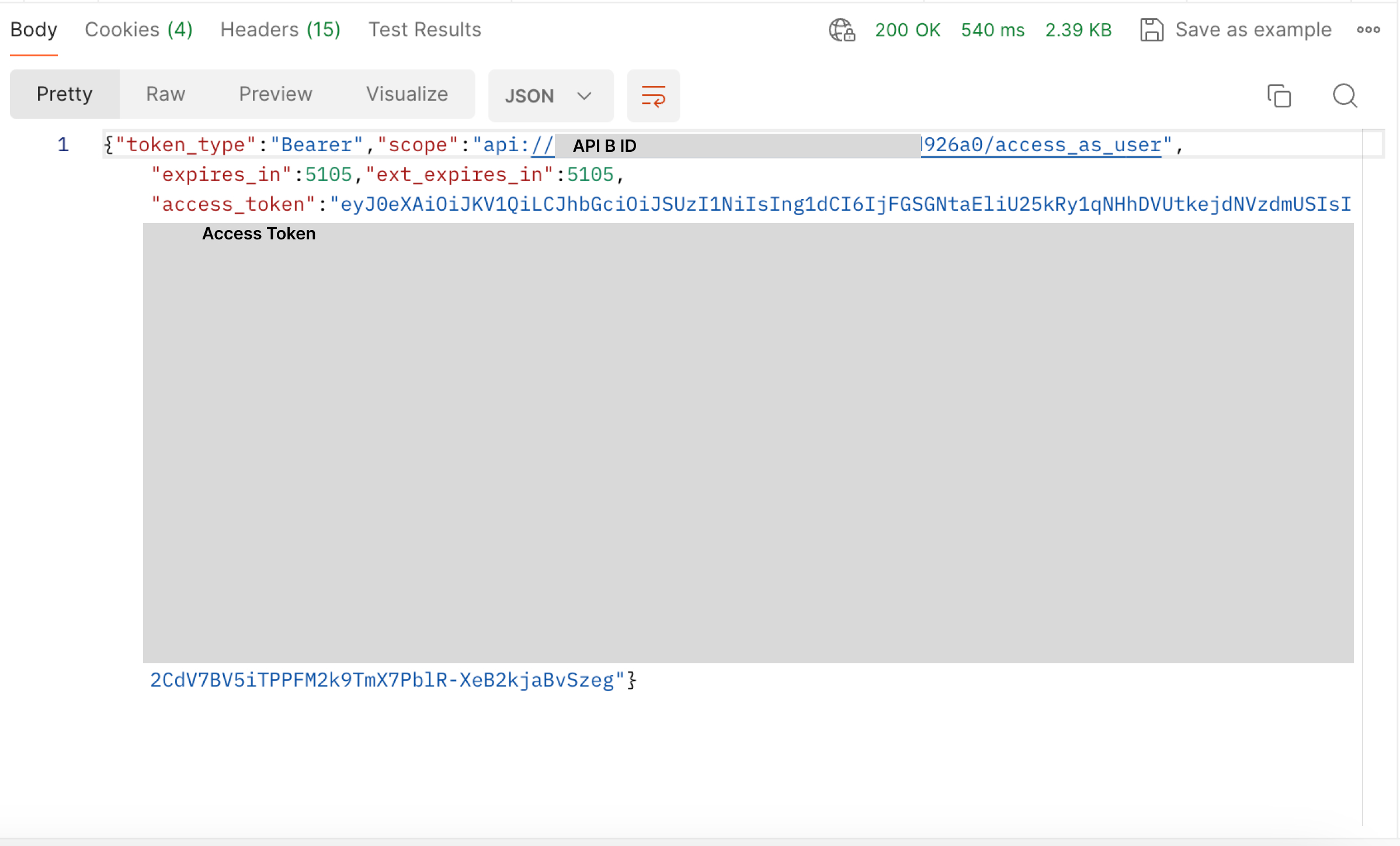

which gives me a successful response: Token A Response
I believe that this access_token is what the OBO docs refer to as "Token A". I then take this token, and make a request to the /token endpoint for API B, like so: Frame 1

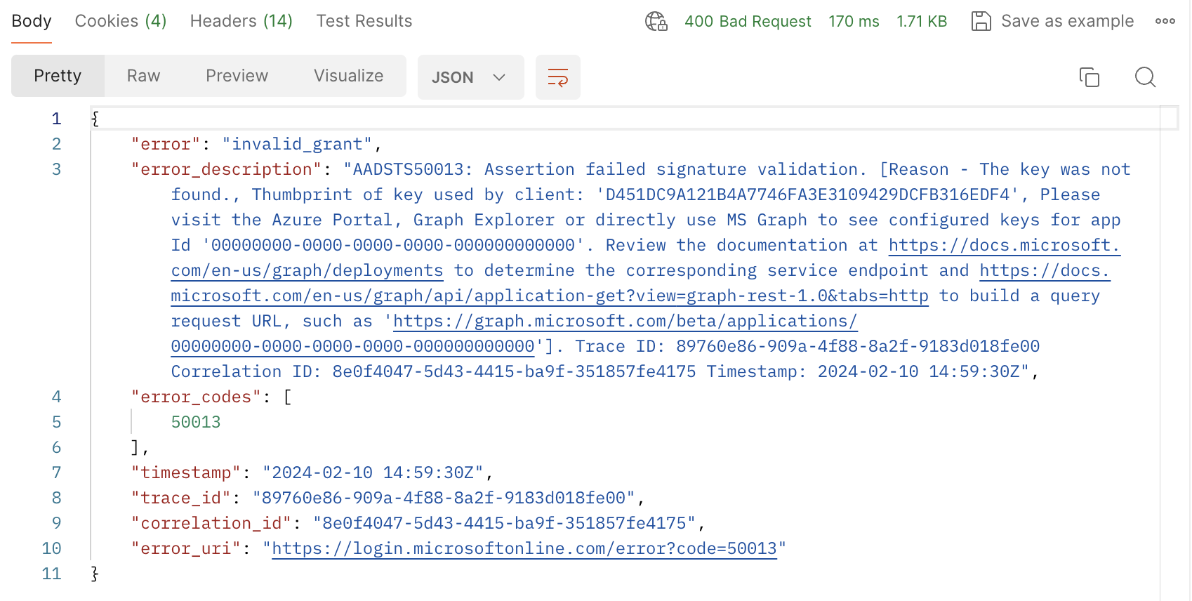

Which gives me the error response: token-b-response
I have been stuck on this error for days now, and nothing that I have done seems to fix it. I should mention, that I was able to successfully authenticate directly with API B usnig the authorization code grant flow, and load the data from my Snowflake API in this way, so it seems that this API is properly configured, but now I need to get the OBO flow working. Please help me!

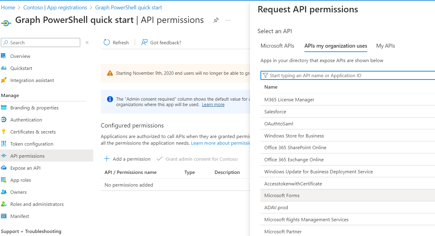

    And now add the scope for API B such as access_as_user and now grant the permission for API to use the scope. To do navigate to API permissions -> Click Add Permission -> Search with your application ID -> In the Delegated permissions section, ensure that the right permissions are checked which are shown in the below.
