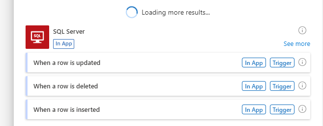

Hi I am using standard logic app built in sql server connector to connect my on prem sql server DB. Authentication is the connection string Server={your-server-address};Database={your-database-name};User Id={your-user-name};Password={your-password}; format. However, I am getting login failed for the user. I can connect to DB without any issues on SSMS. could the domain name cause issues? e.g. contoso\userID? Please advise. Thanks
