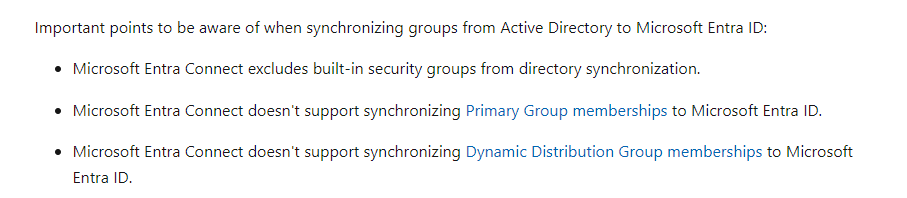

    All groups should sync unless they are the following:
    https://learn.microsoft.com/en-us/entra/identity/hybrid/connect/concept-azure-ad-connect-sync-user-and-contacts#groups
    Why not create an Azure security group instead and add the required members from each domain then assign that to the Enterprise App?
