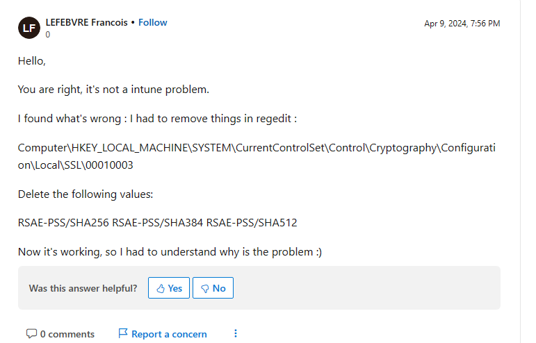

    Hello,
    You are right, it's not a intune problem.
    I found what's wrong : I had to remove things in regedit :
    Computer\HKEY_LOCAL_MACHINE\SYSTEM\CurrentControlSet\Control\Cryptography\Configuration\Local\SSL\00010003
    Delete the following values:
    RSAE-PSS/SHA256 RSAE-PSS/SHA384 RSAE-PSS/SHA512
    Now it's working, so I had to understand why is the problem :)
