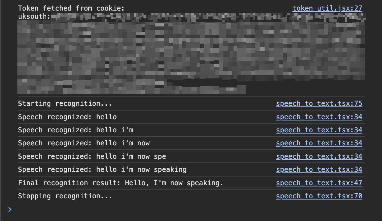

Working locally on Chrome: Working locally

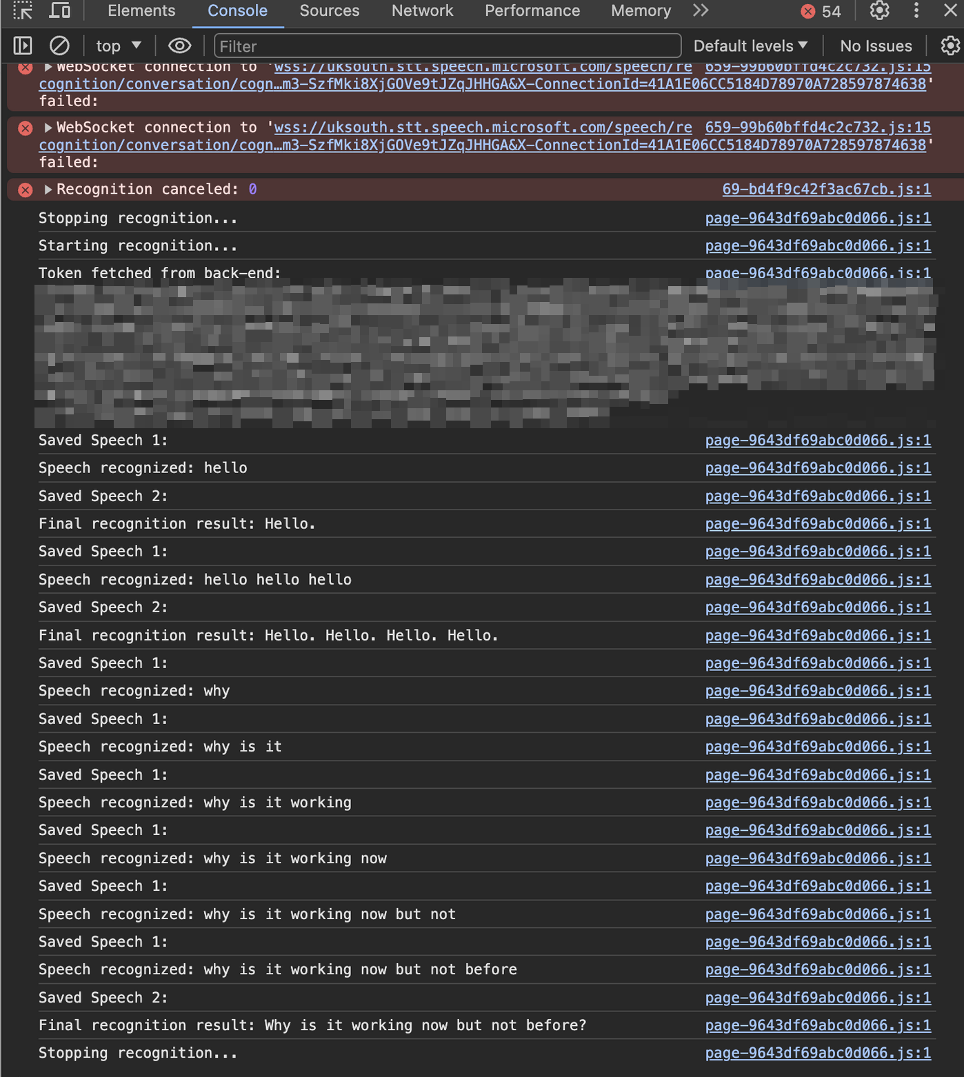

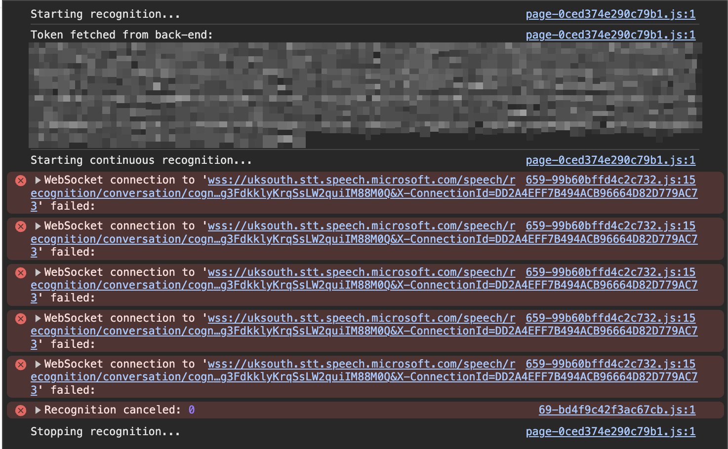

Issue on Azure VM: User's image

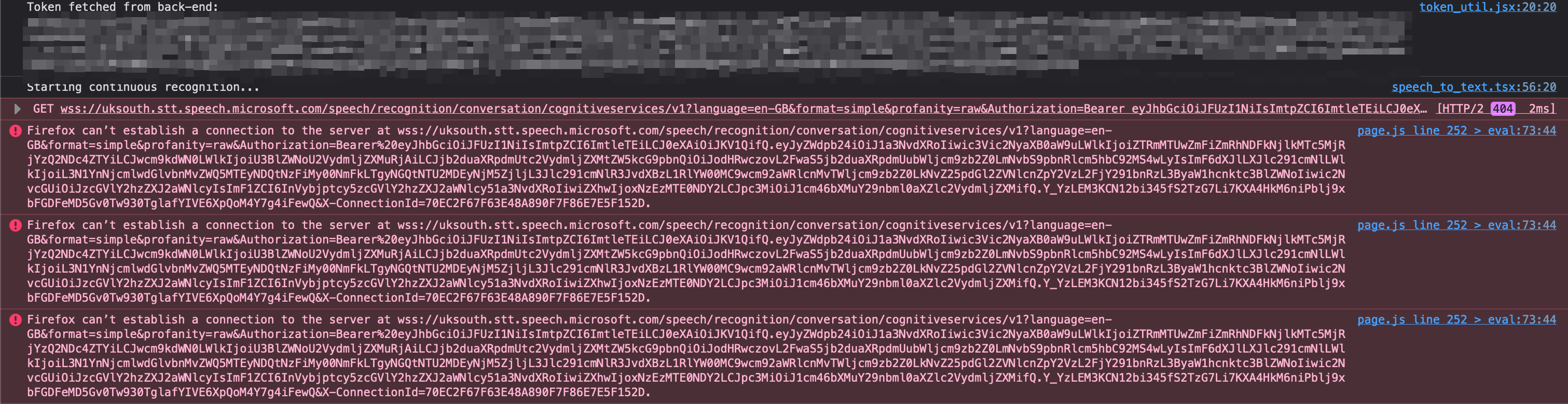

Also the local version works on chrome and edge but it doesnt work on firefox and gives a similar websocket error as on the server:
Heres a screenshot of it not working then briefly working on the server:
I'm not seeing any specific error messages or logs in the Docker container, except for the WebSocket error in the browser terminal.

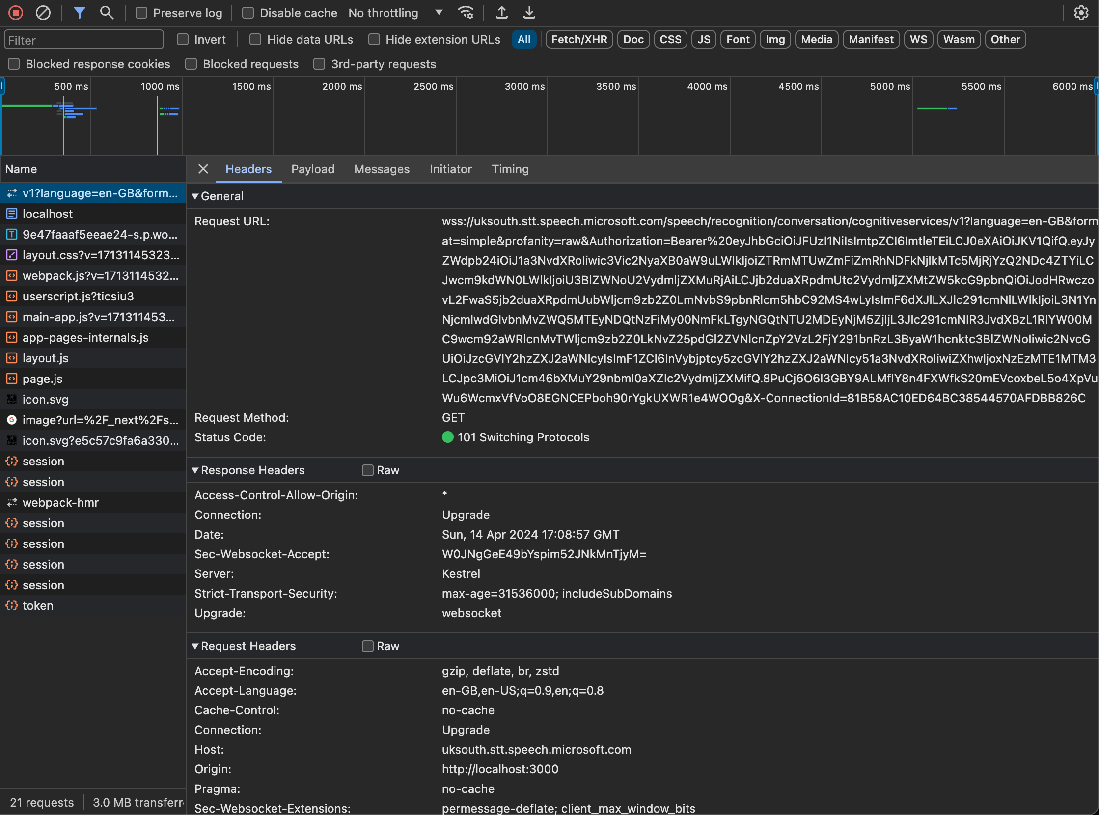

Heres what the network log looks like when running locally:

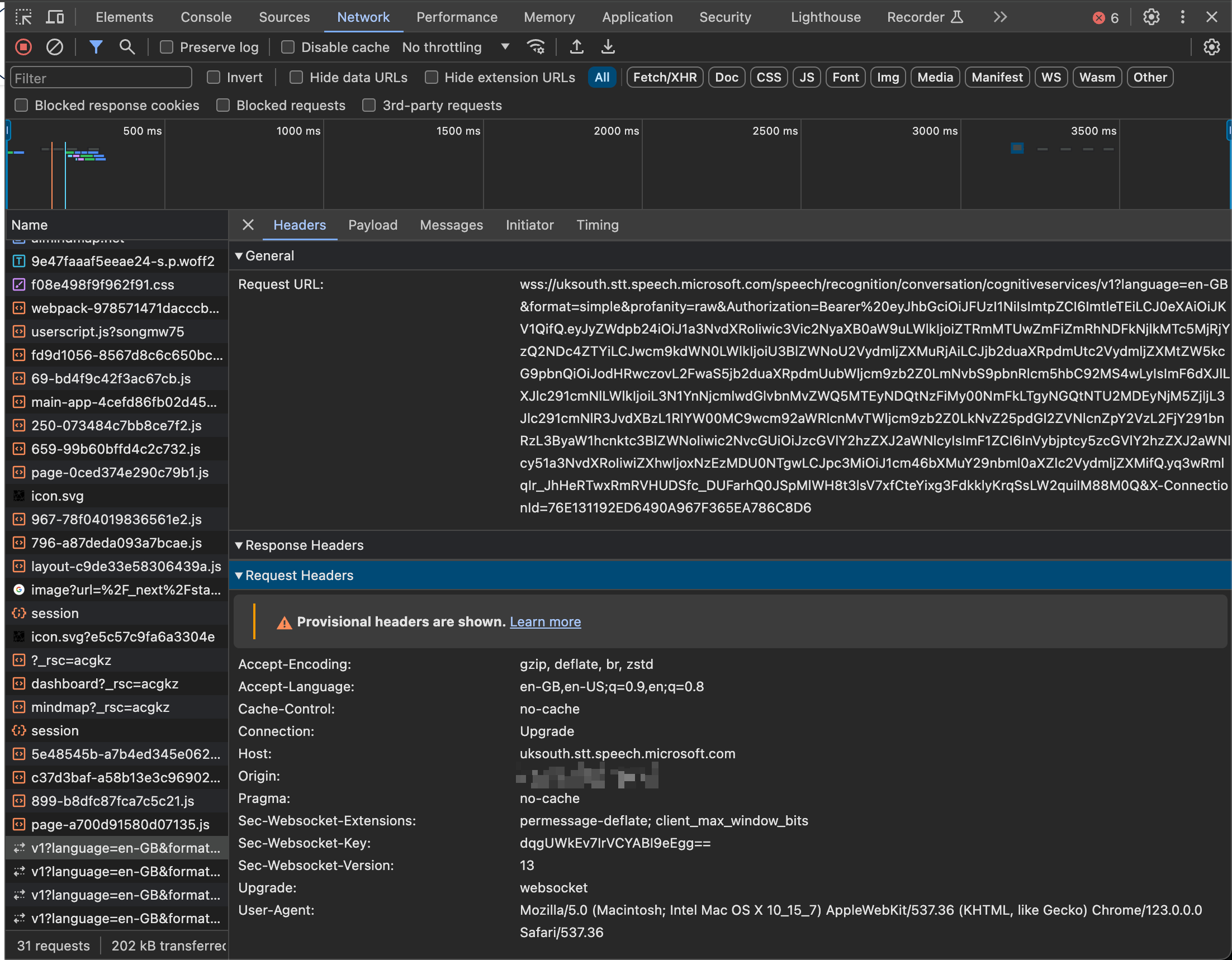

User's image Network log on server seems to get no response from azure:
