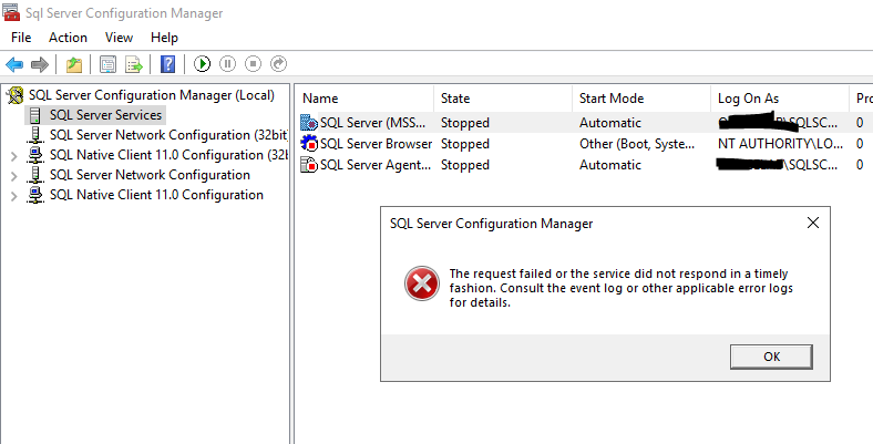

I have set up a new configuration manager lab, everything seems ok, but I can't connect to my configuration manager site. After some troubleshooting steps, I find the SQL server services are stopped and I can't start these services, see the error screenshot. What's the next step should I do?
sql error

    1,We can add the log on account in the SQL logins to have a try. Open SSMS and connect to the site database, then navigate to <Server>/Security/Logins, check if the computer account is there. If not, add it. If yes, remove it and add it back with the same setting. Then check the results.
    2,We can also try to use a domian admin accout in the log on accout to have a try.
    3,Please check the event log under Windows logs\Applicaiton to see if there is any further information about the login failure.

    It says to look at the event logs, likely for the service. What does the log say for why it failed to start the service?
    Did you try a time-honored reboot yet?
