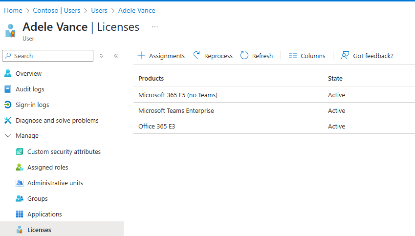

    Hi @Marco Tomatis
    This error is due to the fact that your account does not have a valid MS 365 License, please check whether your account is licensed in Azure, if not, try purchasing or free trial MS 365 license for your tenant, then go to Azure AD and grant that license to the logged in user.
    Hope this helps.
