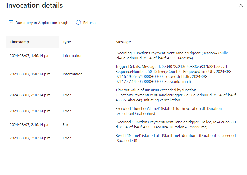

My Spring Cloud Function does not get triggered and does not print the contents of the trigger method when deployed to Azure, but works fine on my local machine

  1. Amira Bedhiafi 43,036 Reputation points MVP Volunteer Moderator
    2026-05-10T15:35:01.21+00:00
    Hello Terence !
    Thank you for posting on MS Learn Q&A.

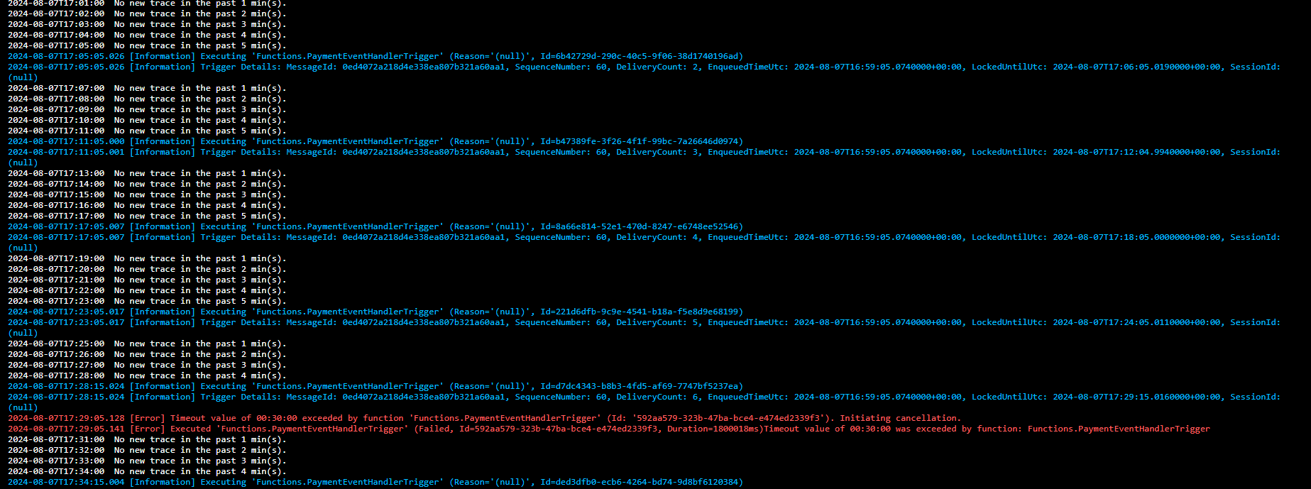

    Your func is being triggered in Azure and the evidence is:
    Executing 'Functions.PaymentEventHandlerTrigger'
    and the same service bus message is retried with increasing DeliveryCount so the real issue is that the invocation doesn't finish and eventually hits:
    Timeout value of 00:30:00 exceeded
    I think your code is hanging before your custom logs are written.
    Message messageTest =
        (Message) AzureFunctionUtil.enhanceInputIfNecessary(message, context);
    For a normal Java Azure Function Service Bus trigger, you do not need this line since it can bind the message directly to a String.
