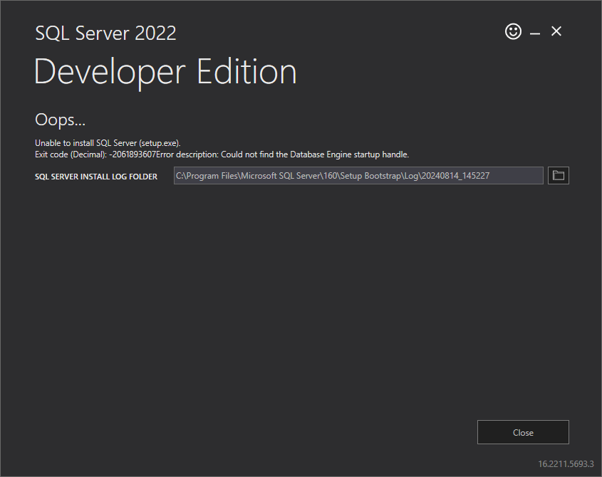

I am trying to install SQL server 2022 on windows 11. But the installation always gets stuck on SQLEngineDBStartConfigAction_install_configrc_Cpu64Screenshot 2024-08-15 143042
Then after some time it shows an error: -Screenshot 2024-08-14 151116 I have tried everything from completely uninstalling, to changing right etc. but its not getting resolved. I am in urgent need of SQL server. I had installed it prior to this and It was working fine but I uninstalled it and as tried reinstalling it I have been having this issue. I have tried different solutions and i have multiple instances on my system and i'm unable to remove them. I also tried repairing through the SQL server installation center, that won't work either.Screenshot 2024-08-16 100725

  1. Erland Sommarskog 120.1K Reputation points MVP
    2024-08-16T21:13:17.9033333+00:00
    I think this is a more precise answer than the AI-generated one.
    The message Wait on the Database Engine recovery handle failed is a generic error that means that SQL Server did not start when Setup wanted to run configuration steps. To understand why it did not start, you need to look in the SQL Server errorlog, which you find in C:\Program Files\Microsoft SQL Server\MSSQL16.MSSQLSERVER\MSSQL\LOG\ERRORLOG.
    If you see a message about 256 misaligned reads, you are running into a known issue where Windows 11 for some disk drives reports a sector size that SQL Server does not cope with. Microsoft has published an article with workarounds for the problem.
    If you don't see the message about misaligned reads, feel free to upload the errorlog here, so we can look at it. You will need to rename to ERRORLOG.txt for the forum software to accept it.
