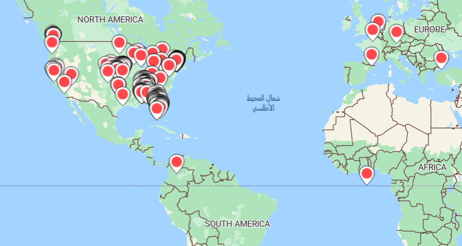

  1. Low-Quality SVG Images:
I'm using SVG images in my application with the Azure Maps SDK, but they appear faint and of poor quality on the map. While they're visible, the detail is lacking (see attached screenshot). Could you suggest any factors that might influence SVG image quality in Azure Maps, or any optimization techniques I could employ?

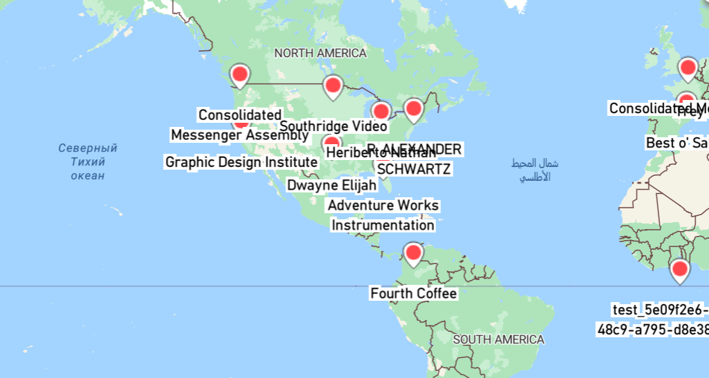

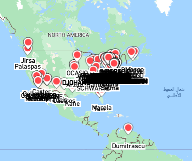

  1. Overlapping Marker Labels:
I'm encountering an issue where marker labels are overlapping each other, creating a cluttered appearance on the map (see attached screenshot). Are there any built-in mechanisms or strategies in the Azure Maps SDK to manage marker label placement and prevent overlap?

    1. In order for SVG images to be used with a symbol layer, they must be converted to an image. This is done by the map when you add the SVG to the image sprite. Scaling can be a cause for blurring, so make sure your SVG has a viewBox, width, and height value defined, otherwise the map will have generate a large image then scale it down which could cause blurriness.

    1. By default this does not happen. You must have changed some of the textOptions on the symbol layer as label collision detection is enabled by default. If you have them, remove the following textOptions or set them to false; allowOverlap, ignorePlacement
