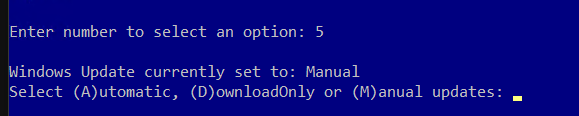

  1. Stanislav Zhelyazkov 29,306 Reputation points MVP Volunteer Moderator
    2024-08-26T05:38:31.9333333+00:00
    In short Azure Update management does not configure the Windows Update settings on your machines. It is up to you to configure those machines to manual installation of updates otherwise automatic update on the machine will install updates regardless of the Azure Update Management schedules.
