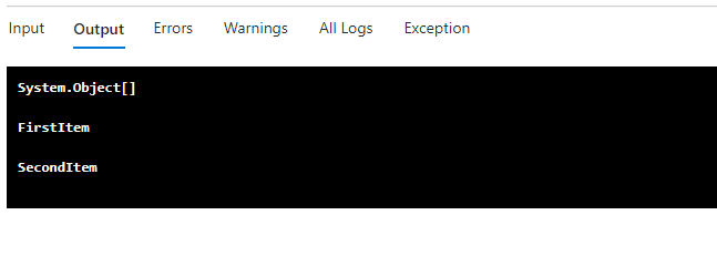

We have a few runbooks that use the PARAM() statement so that you can feed the runbook parameters for each situation. When starting the runbook using the start-azautomationrunbook cmdlet, if I used an array as a parameter, the runbook would treat that parameter as an array as we would expect using the PS5 environment.

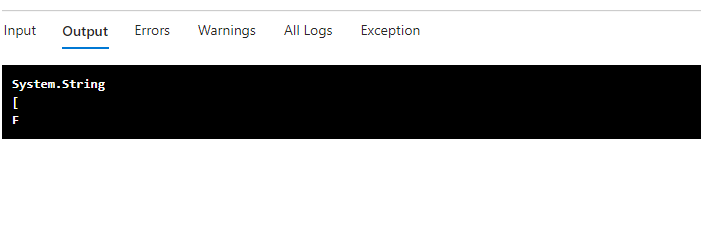

However, recently we have been moving our runbooks to the PS7 Environment and we have noticed that when using the same code, any time we use an array in the exact same runbook results in the parameter being changed to a string value. I am curious if anyone else is running into the same issue. This appears to be only happening in Hybrid.
To test, create a runbook in the PS7 environment and use the following as your first line of code:
PARAM($receivingvariable)
#Output Variable Type
$receivingvariable.gettype().fullname
$receivingvariable[0]
$receivingvariable[1]
Then launch the new runbook using start-azautomationrunbook using Hybrid
$array = @("FirstItem","SecondItem")
start-azautomationrunbook -name <NameofRunbook> -automationaccountname <automationaccountname> -resourcegroupname <nameofresourcegroup> -parameters @{'receivingvariable' = $array} -runon <hybridworkergroup>
Then look at the results of the runbook job and if the output is string or object. Then change the runbook to use PS5 environment and try again. See if the result is System.Object
PS7:
PS5:
