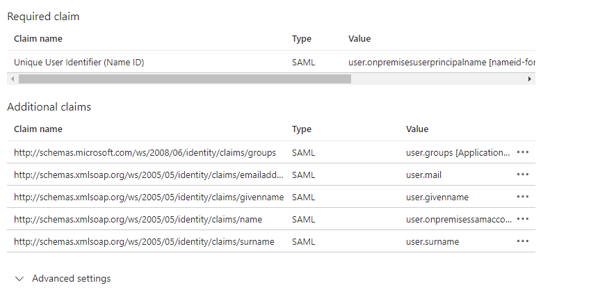

In my "Set up single sign on" attributes & claims I have the following:

When using "Group – SSO with User Directory", it authenticates successfully at Entra ID, but my application shows that my user do not have permission.
