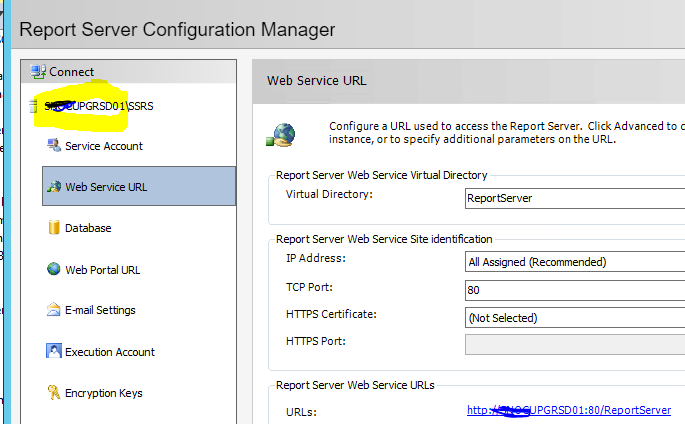

    For next step we will do is to change the new server computer name the same name as the old production server. The server name will be changed by our network engineer, then I will change SQL server name at the local sql server using sp_drop_server and sp_add_server. And I also need to reconnect the database point to new server name and databases. then restore the encrypted key again.
    My question is in below picture after he changed the server name, will the highligted part be automatically change to the new server name, or it still is the old computer name?
    Also we want to rename the old computer and its reporting service too so that we can keep it a little while and to compare some reports if needed with the new server reports.

    So when you say "After you rename the server name, when you open the SSRS configuration manager it will prompt to connect to the server which you may choose the renamed server."
    Is the prompt showing up the first thing I open the configuration manager? I know on the database tab I need to reconnect to the new renamed SQL server instance name and database, but how about the highlighted part on above screen, when I first open the report configuration manager, does it automatically change to the new computer name or it wait after I am done with the database tab?
    This is something hard to test for I cannot rename the server name and has to wait the network people change it.
    The other approach I am thinking is: first stop the old server reporting service, and then the network people change the computer name first, then I install SSRS service, create a new reporting db, this will add roles to the master and msdb dbs. And then restore the databases and encryption key that are from old server. This way I don't need to rename the SQL instance name and reconnect, but I don't know if it will work or not, since the restored db has the same server name and the key as the old server name.
  4. Anne 281 Reputation points
    2020-12-25T01:59:57.917+00:00
    Thanks I tried that and I see it first thing pops up is to let me find the server name and connect, I guess from here I can put in the new server name, and then in database tab to reconnect to databases and then restore the encrypted key.
