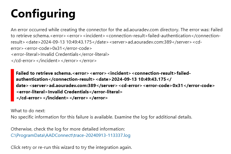

I have recently migrated my AD instance to a new server and am trying to setup entraID again.
However despite my best efforts whenever I go to set it up using the same details as before I get the attached error.
I can successfully ping the port and it is open using TNC.

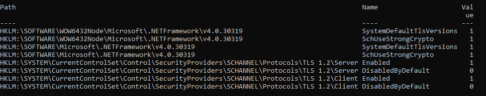

    Ensure you installing the latest version and you have enabled TLS 1.2 on the server, its required with the latest ver.
    More info here on how to enable 1.2:
    https://learn.microsoft.com/en-us/entra/identity/hybrid/connect/reference-connect-version-history#looking-for-the-latest-versions
