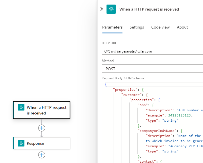

I have created a test flow in standard logic apps using designer. The flow has one trigger and a response. There are no other actions specified. Upon save, the url is not generated. Did restart of logic apps but same response. Also tried to run the flow with "Run with payload" option but failed with ajaxExtended call failed.

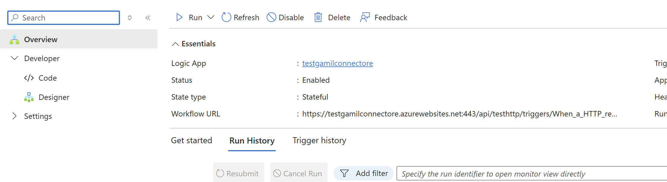

    @Radhika KANNAN Thanks for reaching out. Unfortunately, I am unable to reproduce this issue on my end. It seems the HTTP URL was not generated upon saving, which could be due to a browser issue. Please try using a different browser. You can also retrieve the URL from the Overview page as shown below.User's image
