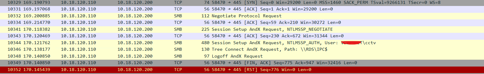

I have cctv camera and only can connect to share folder using SMBv1 version. When i try connecting this cctv to standalone windows server, the cctv is able to connect.
When i change the connection to windows server which joined to Active Directory, the cctv is not able to access the share folder even SMBv1 is enabled.
When i try capture using wireshark i got connection reset, anyone know why?

  1. Handian Sudianto 6,666 Reputation points
    2024-09-30T06:20:49.4066667+00:00
    Hi..
    The problem already solved by disable the SMB signing on the local policy.
    Microsoft network server: Digitally sign communications (always) set to disable.
