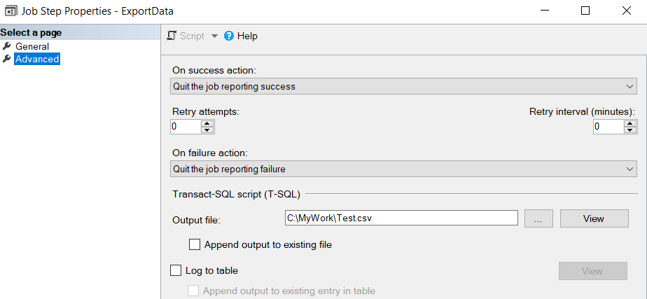

  2. Zahid Butt 966 Reputation points
    2024-10-17T18:25:37.7033333+00:00
    This can be achieved through Creating a SQL server job with a specific schedule & selecting path for a file to save output. Please go though below link to do this:
    https://database.guide/create-a-sql-server-agent-job-using-ssms/
    When you have done, then edit job step , go to advanced property & give file path for output:
