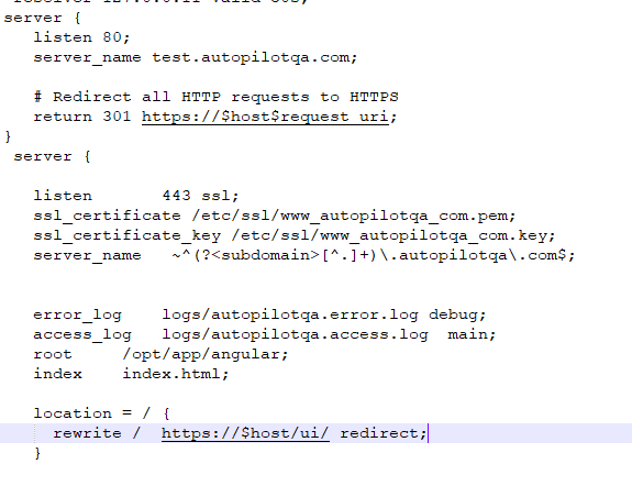

I have dockarized my application. It needs nginx to start. Front end is Angular and backend is Java spring boot. I am using spring security
I want to use azure app service to start my application.
  1. how can i access my application with url provided by azure app service?

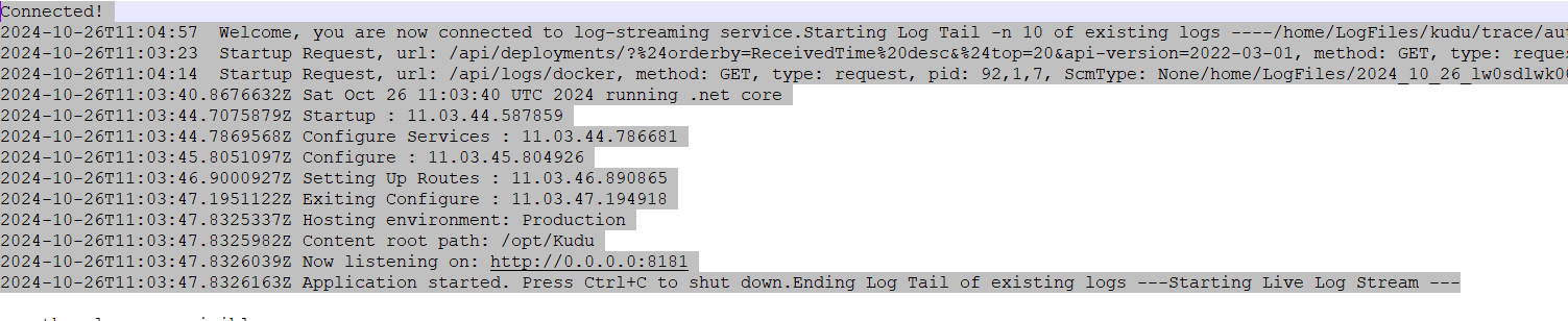

    Please enable and review logs to fetch more details about the error and let us know: #enable-application-logging-linuxcontainer and Access log files

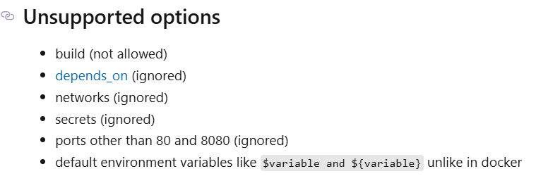

    By default, App Service assumes your custom container is listening on port 80.
    If you’re running a (custom container) with Web App for Containers, use WEBSITES_PORT. Ensure that this is set to the port that’s also exposed in your Dockerfile through the EXPOSE instruction Vs On App Service Linux, using (Blessed Images) - use PORT, which directly influences the container port of the docker run command.
    Ensure that your application is listening on the correct port. In your Dockerfile, you have EXPOSE Ports', make sure these ports are correctly configured in your application code and match the ports exposed in the Dockerfile.
