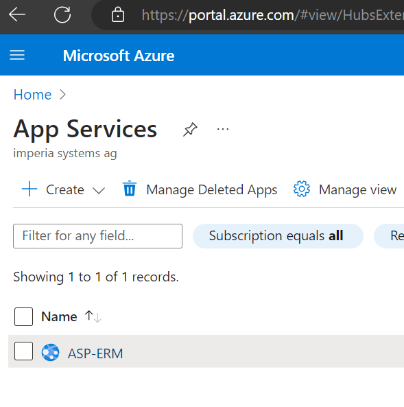

    You may also try Resetting your "publish profile". You can reset it from the Azure Portal at your web app.
    enter image description here
    Let us know.
