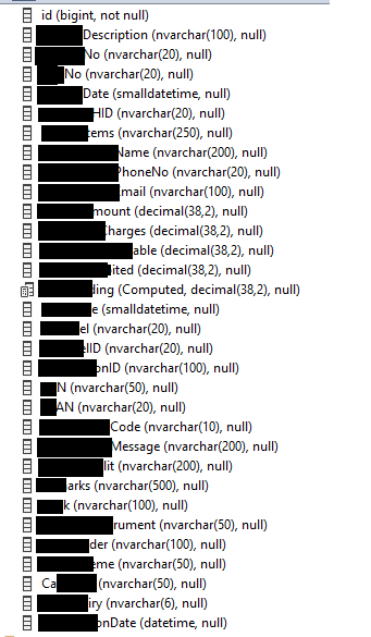

Here is a snapshot of the structure of table A with the trigger
mytable
Here is a snapshot of the table B
desttable
