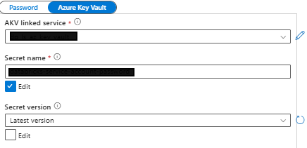

    The issue was resolved after I used Azure Key Vault to provide the password, instead of directly specifying it in the Password property.
    Below is the error message I found in the log of the self-hosted integration runtime server.
    Property name: password, Exception: 'Type=Microsoft.DataTransfer.Common.Shared.HybridDeliveryException,Message=Failed to convert the value 'Masked Secret' in 'password' property to 'Microsoft.DataTransfer.Security.SensitiveString' type. Please make sure the payload structure and value are correct.,Source=Microsoft.DataTransfer.DataContracts,StackTrace= at Microsoft.DataTransfer.Common.Shared.HelperMethod.ConvertTypeT
