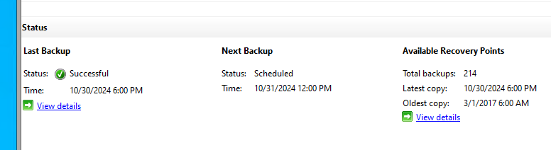

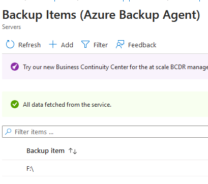

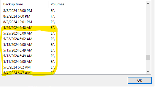

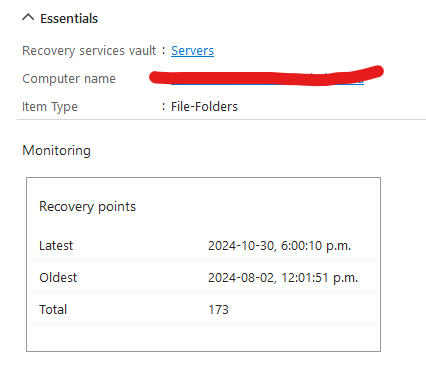

We use Azure Backup to backup our on premise server. Recently we got a new server and switched drive letters. I am unable to view or delete the old drive letter from Azure backup. The retention policies are not being honoured because the drive letter is different? I am also seeing a mismatch of Total Backups within the agent vs the online portal. I'm thinking something isn't quite right.
Agent:
Online Portal:
Online Portal:
I've searched everywhere within the online portal but am unable to find E:\
