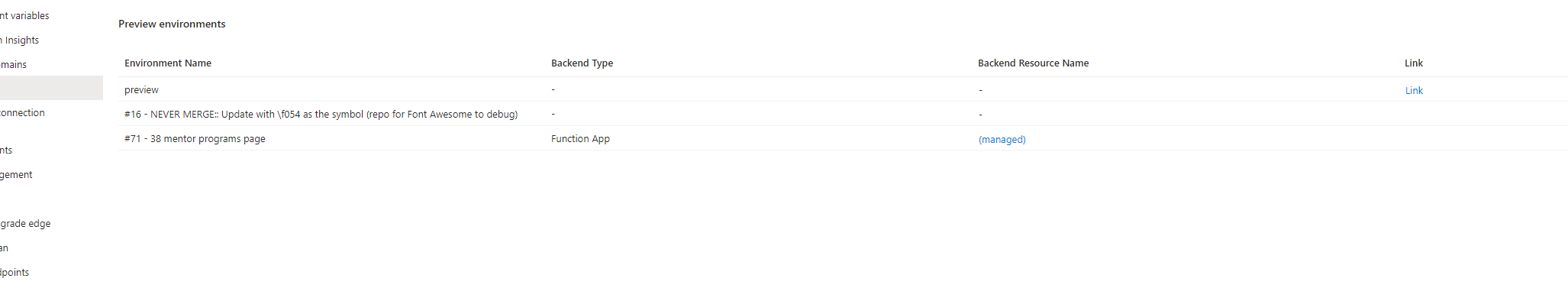

I'm having a problem with the API deployment and I don't see any error messages. It looks like its deploying the API, but in the APIs tab does not show any active APIs.
Why might this be the case? What else can I look at to debug?

    If you can hit https://your-static-webapp.azurestaticapps.ent/api/<your-endpoint> then more than like it's a portal issue where it's not detecting the function properly. However, you can't hit your API endpoint, then that leads me to believe it's deployment issue where the app code wasn't deployed as expected. In that case, I would start back with a basic Build configuration, see if that works. Then incrementally make the necessary changes as deemed fit.
    EDIT 2024 Nov 18 Glad to see that your issue was resolved by setting api_skip_build to false as part of Azure/static-web-apps-deploy task. My thinking as to why that works, based on https://github.com/Azure/static-web-apps/issues/343, is because you're already building your API and pushing those artifacts to the resource. By telling the underlying platform to skip building it, it will use those built binaries rather than looking for the files to build the output.
