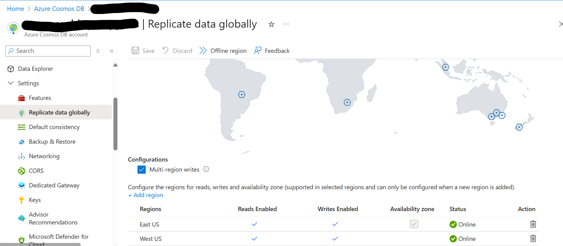

We are using Azure CosmosDB with both EUS/WUS regions in PPE environment. We are observing more latency in WUS region. In our EUS service the Read latency is below 100 ms which is the CosmosDB primary region. But Read latency is around 400ms our WUS service. So can you suggest how to reduce it, is there any settings. Also, we are using azure-spring-data-cosmos java library. And the diagnostic logs from the library always shows that our EUS/WUS service try to connect with physical address rntbd://<cosmosdbname>-eastus-documents.azure.comimage (3)

    It sounds like you’re experiencing higher latency in the West US (WUS) region compared to the East US (EUS) region for your Azure Cosmos DB. Here are a few suggestions to help reduce the latency:
    1. Ensure Preferred Region Is Set Correctly in Client SDK
    • Even with multi-region writes, your application in WUS should still prioritize the local WUS region for optimal latency.
    • Double-check that the preferredRegions setting in the azure-spring-data-cosmos library is configured to use WUS for your WUS-based service. This ensures that read requests and multi-region writes in WUS go to the nearest replica. If this setting isn’t correctly applied, requests may still be routed to EUS, leading to unnecessary latency.
