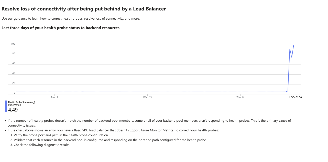

this is the current diagnostic page on the load balancer :

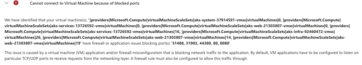

I checked all the ports in the error message and all of them are opened on the NSG.
