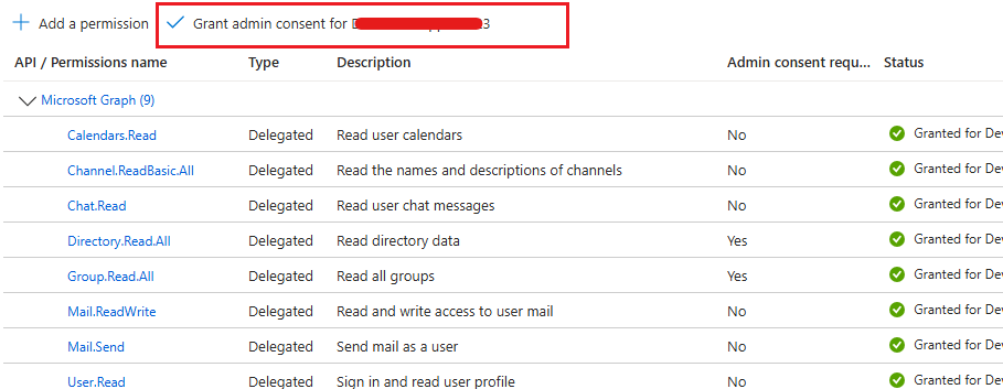

  1. CarlZhao-MSFT 43,011 Reputation points
    2024-11-29T06:23:51.3433333+00:00
    Hi @Nicolas Calder
    This is because the above permissions have not been granted admin consent.
    Log in to MS Entra ID as a global admin > App registrations > find your app > API permissions > Grant admin consent for xxxxxx.
    Screenshot 2024-11-29 141956
    Hope this helps.
    If the reply is helpful, please click Accept Answer and kindly upvote it. If you have additional questions about this answer, please click Comment.
