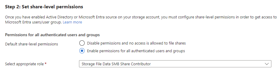

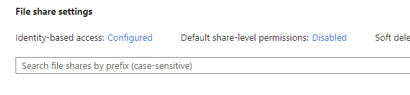

    It shows the default share-level permissions are Disabled. However, I'm unable to turn them on. If I go in and set something:
    I get the following error when clicking Save:
    I had the same issue when I tried enabling Microsoft Entra Domain Services. I found a post elsewhere that showed the Azure PowerShell script to run to enable EDS on the storage account, so I was able to get around it.
