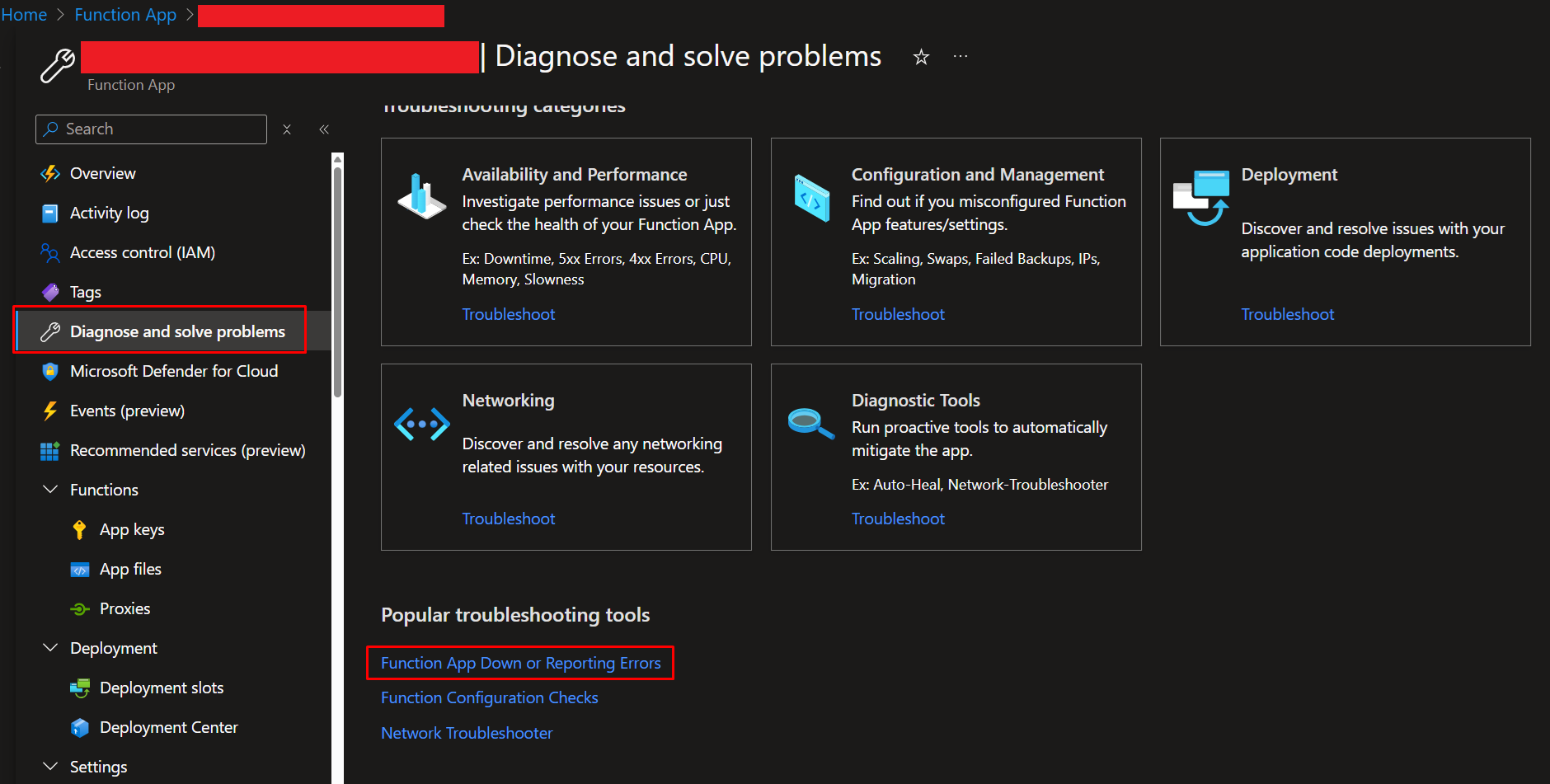

    To troubleshoot host-related problems, check the "Diagnose and solve problems" section in the Azure Portal under the Function app. Use the "Function app down or reporting" detector to view detailed diagnostics about the app and infrastructure.

    If the runtime is unreachable, please troubleshoot the function app using built-in detector under Diagnose and solve problems in Function app as @Gabriel Santana suggested.
