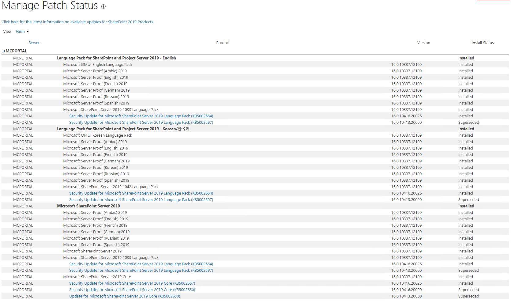

In SharePoint 2019, after applying KB5002639 and subsequent updates, deploying BCS solutions is not possible.
seungjae lee 35 Reputation points
2024-12-30T09:07:07.5733333+00:00
In SharePoint 2019, after applying KB 5002639 and subsequent updates, deploying BCS solutions is not possible.
Error messages is
DotNetAssembly/WebService system type is not supported.
Error was encountered at or just before Line: '4' and Position: '6'.
Error log: BCS_Deploy_Error.txt

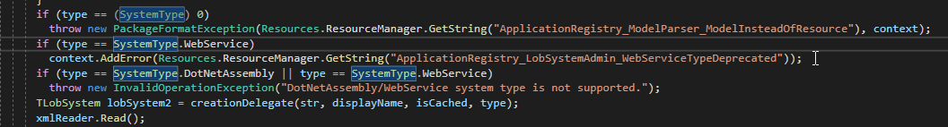

  1. Mehdi Feghouli 80 Reputation points
    2025-01-10T17:56:46.21+00:00
    @seungjae lee here is the catch, it appears that MS Team has added a deprecation in the BDC Service (This is extracted from Decompiled Microsoft.SharePoint.dll)1000023555

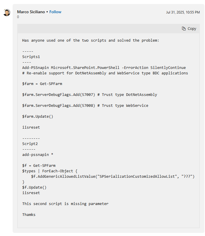

  1. Marco Siciliano 5 Reputation points
    2025-07-28T13:08:19.4433333+00:00
    Hi everyone,
    just patched our SharePoint 2016 farm to 16.0.5513.1001 with the July 21 2025 security updates:
    • KB 5002760 (STS)
    • KB 5002759 (WSSLOC)
    Now all External Lists that use a DotNetAssembly BDC model blow up.
    ULS spits out:
    System.InvalidOperationException:
    Error at Line 4, Position 6
    Database/OData ECTs are fine — only the .NET ones die.
    Based on what I’ve read in this thread and on my own experience, I have to conclude that this patch has re‑introduced the same issue we saw with the previous one.

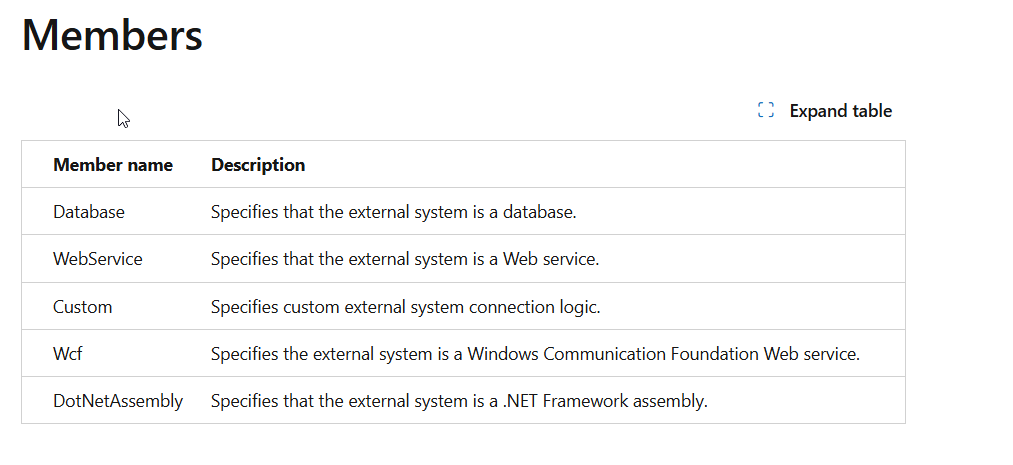

  3. Schmidt, Roger 6 Reputation points
    2025-07-21T13:54:55.9733333+00:00
    Hello everyone
    The Accepted answer is not a solution.
    Please check this announcement:
    https://learn.microsoft.com/en-us/sharepoint/business-connectivity-services-retirement
    It should not impact SharePoint 2016 & 2019 Server (on on-premises).
    This feature will remain supported in SharePoint Server 2016 and SharePoint Server 2019 until those products reach their end of support date of July 14, 2026.
    Is there anyone who can comment on this?
    It is really a problem for us!
