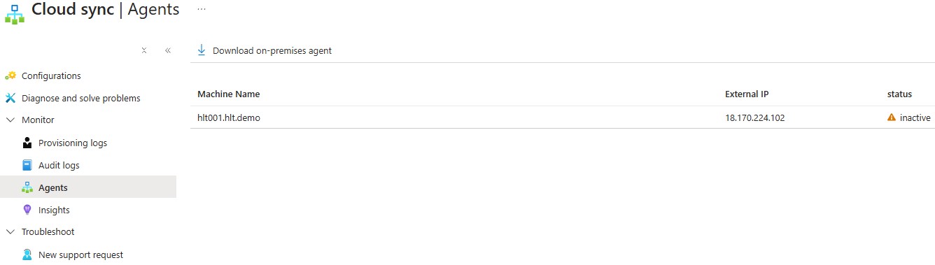

Hi
How would I go about deleting an old cloud agent in the Azure portal ?
Regards
G

    Any unused connectors/agents are tagged as inactive and are removed automatically after 10 days of inactivity.
    So, you may not need any action from your end. This is cited from: https://learn.microsoft.com/en-us/answers/questions/1310381/unable-to-remove-old-azure-cloud-agent-from-aad-po

    Once you uninstall the Provisioning agent, below is the expected behavior,
    1. If you shut down a connector (or uninstall the agent), the traffic immediately gets load-balanced to the other healthy connectors in the same connector group.
    2. After 1 hour, a connector becomes "inactive" in the UI. It still shows up in the UI, but with status=inactive.
    3. After 10 days, a connector becomes "soft deleted" in the system. At this point, we don't even load the data for that connector from our SQL DB. The data is still in the DB, we just don't load it. The agent is not displayed at the UI anymore.
    4. A connector can still go back to fully active status, even after it is soft-deleted. The agent is only ever gone for good after its agent certificate expires. Then requests to Bootstrap service and all other HIS services get denied, the connector can't interact with our systems anymore, and the only solution is to reinstall the agent.
