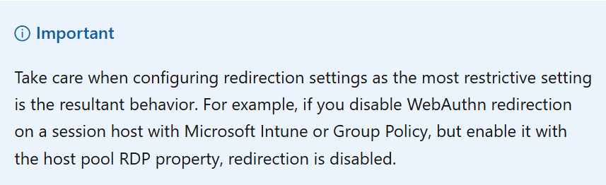

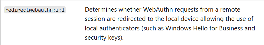

    Check with the default host pool property as per the below image:
    When enabled, all WebAuthn requests in the session are redirected to the local PC. You can use Windows Hello for Business or locally attached security devices to complete the authentication process. If the redirectwebauthn is not enabled you can enable by following the document: https://learn.microsoft.com/en-us/azure/virtual-desktop/redirection-configure-webauthn?tabs=intune&pivots=azure-virtual-desktop
