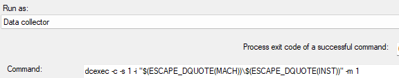

There seems to be a strange error when executing the calls for "Data Collector" on SQL Server 2022.
I have just updated the instance with the latest CU to see if it would fix the issue, but nothing changed.
On the other two instances, simply running from prompt.\dcexec, it returns a message about missing parameters, while on ALEN2022, there is no way to get it to work.
Below the error:
DCEXEC.EXE - Unable to Find Entry Point
Unable to find the entry point ?SQLToolsDiag_TraceMsg@@YAXPEB_WKPEA_WZZ procedure in the dynamic link library C:\Program Files\Microsoft SQL Server\MSSQL16.ALEN2022\MSSQL\Binn\DCEXEC.EXE.
No one error message from SQL SERVER AGENT step (difficult to debug at first glance).
It seems to me something related to the windows sys.
I don't know what to do after a CU update?
Run as "Data collector" is ad-hoc proxy user with right permission that I use on my third named DEV instance (localhost/ALEN) and all go right.
User's imageUser's image
On my 3th DEV instance (2019) job run successful... only in 2022 not!
Do you have some ideas?

  1. Alen Cappelletti 1,047 Reputation points
    2025-02-06T08:53:32.92+00:00
    I Found a quick and dirty solution.
    As you can see I've insert a FULL path to the dcexec of SQL SERER 2019 default instance
    "C:\Program Files\Microsoft SQL Server\MSSQL15.MSSQLSERVER\MSSQL\Binn\dcexec" -c -s 1 -i "$(ESCAPE_DQUOTE(MACH))$(ESCAPE_DQUOTE(INST))" -m 1
    and now job ran successful

  3. Erland Sommarskog 134.4K Reputation points MVP Volunteer Moderator
    2025-02-05T22:11:30.03+00:00
    I tried this on a few machines. On machines where I run SQL 2022 as a named instances, I get the same error messages as you. On machines where SQL 2022 runs as a default instance, I get a "normal" error message:
    dcexec: Missing runtime execution mode. Enter '-?' for help. dcexec: Missing set ID. Enter '-?' for help.
    I also tested with a named instance running SQL 2019. There it works.
    If you need DCEXEC running on a named instance, I would suggest that you open a support case and press for a fix.
