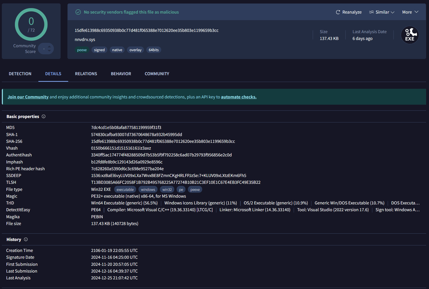

![](https://filestore.community.support.microsoft.com/api/images/b3e90edd-8730-4db7-b7b5-bc5e0196eeba?upload=true&fud_access=hC1SxZhn7m%2FZQJkOIiOVstu10yTQgXS4A%2FDBzZTg8nbaCgIogkrcDydMeI5Y4za2dOqDdWtsG2JNS3E35V60i9TiGHR7STMpJHheeXuDvO8nwjUlqCBHhJ0NDvuYN7OSCnFSNEvLA3nGUQi1itY0Q5iGqmunnoyq0rLbSMEGfvaXhoyBGesXeA7bOcNNX7QpIraX58j%2B8%2FqckJBbYYGlTBgBmkn2V%2BHmIR8cuugxPDQaQ%2FlTPWFsejNt6jJFj73I1egWbjJXJhJqmdBTY9H7kq2G%2FzORRnROFf6UzHKV%2FeUzy6H1ig3IMbJM%2B81Aj9huxU1ihAJeriylQ%2B5Ahuxa54%2FtPOXhpfPzVw3rSe7mStjrluAHGaLXlFTnRGqZEN62ZBXqpIBT8Yd7EyjDWZCUHRmjxsxK1dinBObvZekw1uU%3D)![](https://filestore.community.support.microsoft.com/api/images/72f97730-6255-47bd-933a-c8c708a20f6c?upload=true&fud_access=hC1SxZhn7m%2FZQJkOIiOVstu10yTQgXS4A%2FDBzZTg8nbaCgIogkrcDydMeI5Y4za2dOqDdWtsG2JNS3E35V60i9TiGHR7STMpJHheeXuDvO8nwjUlqCBHhJ0NDvuYN7OSCnFSNEvLA3nGUQi1itY0Q5iGqmunnoyq0rLbSMEGfvaXhoyBGesXeA7bOcNNX7QpIraX58j%2B8%2FqckJBbYYGlTBgBmkn2V%2BHmIR8cuugxPDQEVQ4fAxDXVLl%2BUxXL3vmYySst2lQBZ6oyDk0QMK5k1J9RmJz31WLACb%2B24xhOYqm%2BdvA%2BQmbE0FXfsfSw35mgNl7L8zq%2BoVzk27MxoFYiCK26xueAts8roA%2F50RQm7LQOj9e6KrmPYirFxXnOYC7Dau5Xd5qqk%2BDq9TV4TVDqv6AtbPeSiDOcpFDwnJTBqkU%3D)

    It seems hypervisor is running normally on your machine. Please run bcdedit.exe in CMD and make sure the hypervisorlaunchtype is set to auto.
    What is l1vhlwf.sys? I can find nothing about that. If this is a third-party driver you may need to contact the driver developer.
    2025-01-01T17:35:54+00:00
    Hi Ian_Xue,
    it's a driver also known as nnvdrv.sys and its signature is verified Microsoft.
    Do you work in Microsoft?
    Thanks for the support!!
