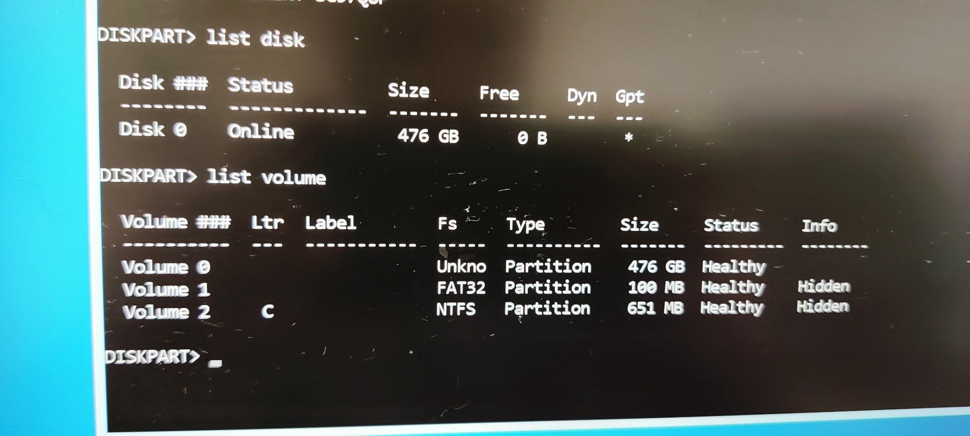

    2025-01-28T12:55:02+00:00
    Partition is there however its in an unknown format :S

    2025-01-28T11:21:30+00:00
    Issue seems to be the below, before encryption partition is visible however after the bitlocker and a reboot the partition is not there anymore.
    Not sure its not visible because its encrypted :S
