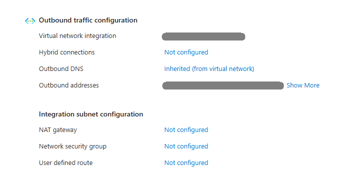

The App Service (Linux Container) with virtual network integration has suddenly stopped working. When attempting to run bash commands(from KUDO Console) for any of the private endpoints, the following errors occur:

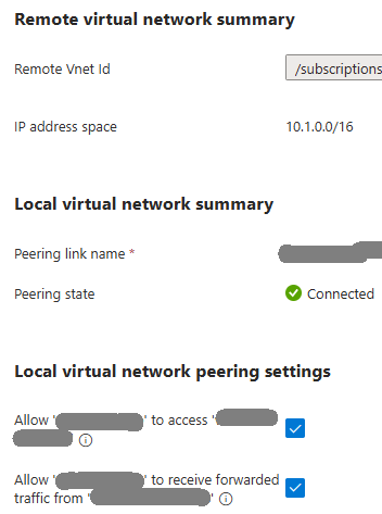

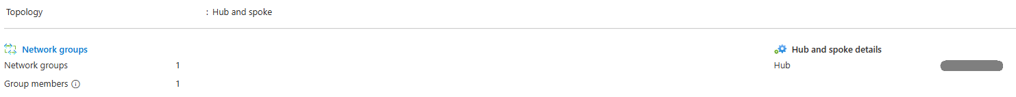

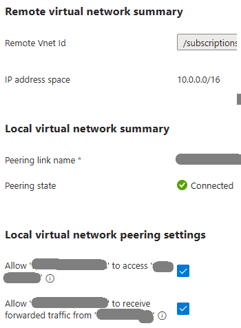

There are two virtual networks: one hub and one spoke. All private endpoints are located in the hub, while the App Service is integrated into the spoke VNet. The hub and spoke topology is managed by Azure Network Manager, and the connectivity configuration has been deployed, and peering created between the VNets.

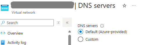

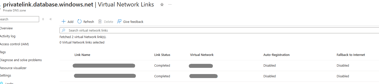

Private DNS zones and links to networks are configured, and Azure DNS is being used.

    • First, make sure the VNet peering and routing are still intact. The changes in the network configuration can impact connectivity.

    nslookup <your-private-endpoint>.privatelink.<service>.azure.com 168.63.129.16
           If that fails, it could mean that your Private DNS zone is not correctly linked to both VNets.
    • Also, check if there are any NSGs, UDRs, or firewalls that might be blocking traffic from the App Service subnet to the private endpoint.
