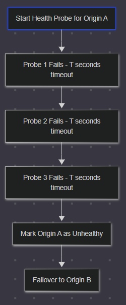

    How long does Frontdoor take to failover to origin B if origin A for some reason goes down? : Azure Front Door monitors the health of origins through health probes. The time to failover to Origin B depends on the probe frequency and timeout configuration. By default, health probes run every 30 seconds, with a timeout of 5 seconds. If three consecutive health probes fail, an origin is marked unhealthy. Based on the default settings, failover to Origin B could take up to 90 seconds.

    • The system does not perform additional checks within the same 30-second interval. Once the third probe fails (at T = 65s, considering a 5-second timeout), the system immediately marks the origin as unhealthy. The health probe mechanism strictly adheres to the configured interval, and additional probes are not conducted inside that interval window. In other words: Health probes are initiated strictly at regular intervals (e.g., T = 0s, T = 30s, T = 60s for default settings). After the third consecutive failed probe, the system marks the origin as unhealthy immediately at the end of the timeout for the third probe (in this case, T = 65s).
    Conclusion: It’s a good idea to run some tests to see how this really works and nail down the actual timings since things like network latency can change the results.
