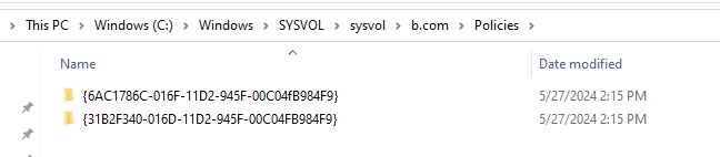

    If you mean the contents in the path C:\Windows\SYSVOL\sysvol\b.com\Policies on both DCs are different?
    For example: User's image
    You can back up the DC one by one and SYSVOL folder on both DCs. Then try the steps in the part of "How to perform a non-authoritative synchronization of DFSR-replicated sysvol replication (like D2 for FRS)" in the following link.
