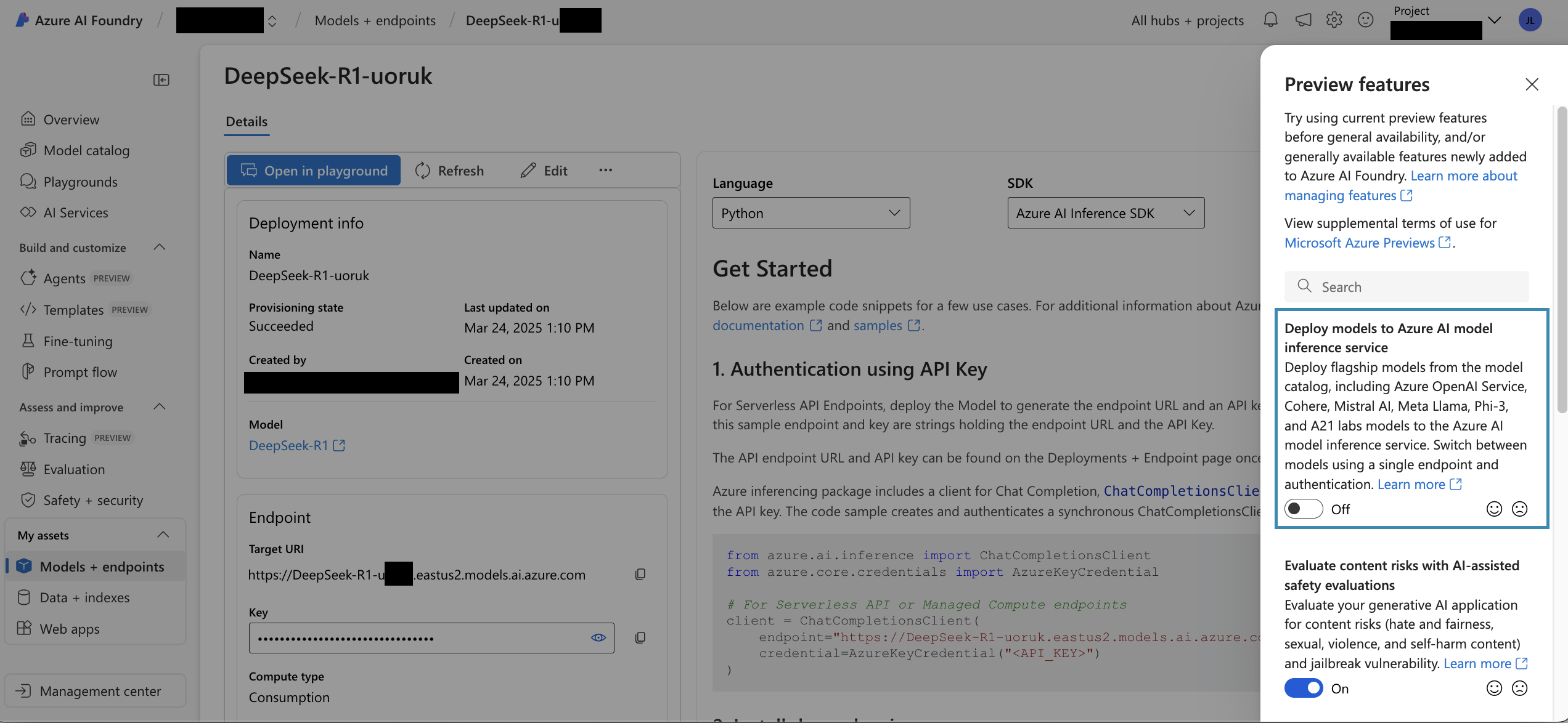

    Thanks for sharing your findings! It looks like the "Deploy models to Azure AI model inference service" toggle being enabled by default was causing the deployment to use the services.ai.azure.com format. Disabling it ensured that the endpoint follows the correct models.ai.azure.com structure.

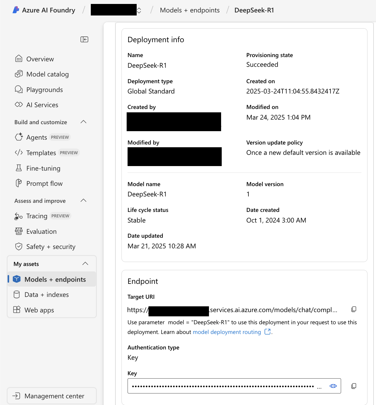

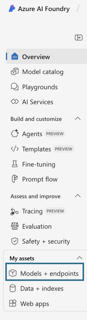

    We are still encountering trouble creating an endpoint with the model.ai.azure.com format after navigating to https://ai.azure.com/, creating a new project, and then deploying the model.
    First, we went to https://ai.azure.com/ and clicked "Create Project" and created a new project as you instructed.User's image
    Then, we browsed into that new project and navigated to the Models + Endpoints option on the sidebar. This menu option leads to a URL with the format https://ai.azure.com/build/deployments/model?...
    Screenshot 2025-03-24 at 12.59.49 PM
    Finally, we attempted deploying the model but it is still showing up with the services.ai.azure.com endpoint. To my understanding, this interface is the Azure AI Studio you are referring to, and not the Azure ML Studio or classic portal flows you referenced, correct?
    Screenshot 2025-03-24 at 1.04.01 PM Screenshot 2025-03-24 at 1.05.18 PM Why is it still resulting in an endpoint of services.ai.azure.com and not models.ai.azure.com then?
  3. Autoize 40 Reputation points
    2025-03-24T11:15:24.73+00:00
    It appears after switching the toggle to "off" for the preview feature "Deploy models to Azure AI model inference service" (which was set to "on" by default), we are now able to deploy an endpoint with the correct format.
    Screenshot 2025-03-24 at 1.12.16 PM
