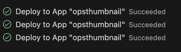

I have developed an Azure Function App (Blob Trigger) in VS Code, and it works perfectly when running locally using func start. However, after deploying it to Azure using VS Code, I cannot find the function in the Azure Portal, and the associated files

  • Deployment Method: VS Code Azure Extension(used the button to deploy Screenshot 2025-04-03 at 1.34.44 AM
below are some images from the portal and the VScode for the observation.

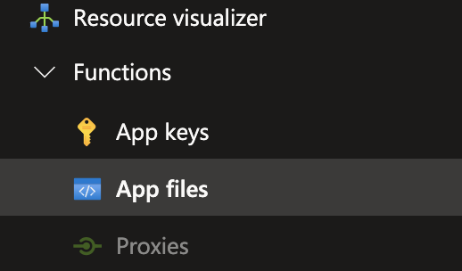

unable to see functions
Screenshot 2025-04-03 at 1.27.45 AM

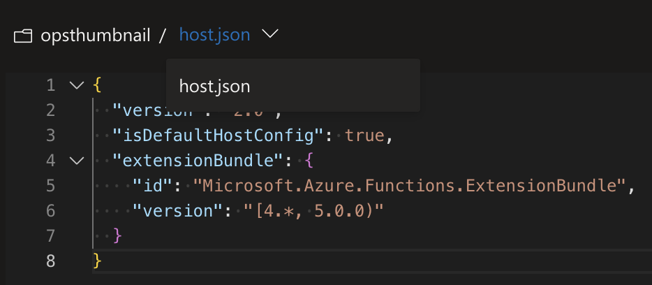

only this file appears.Screenshot 2025-04-03 at 1.27.57 AM
these are two local function have verified their execution locally .Screenshot 2025-04-03 at 1.26.24 AM

    Several common build issues can prevent Azure Functions, like your Blob Trigger function, from being found after deployment. To troubleshoot, start by ensuring that the agent pool used for deployment is running on Ubuntu. This is essential for ensuring that packages are restored properly during the build step.
    Next, check if your function app is located at the root of the source repository. If not, ensure the pip install step references the correct path for creating the .python_packages folder, keeping in mind that the path is case-sensitive.
    Additionally, verify that the deployment package can be loaded into /home/site/wwwroot, which is usually managed by the ArchiveFiles task. If these steps don’t resolve the issue, review the deployment logs for any errors or warnings that could provide more insights into what went wrong.
    For further clarification, please refer to the following documentations: Document1, Document2
