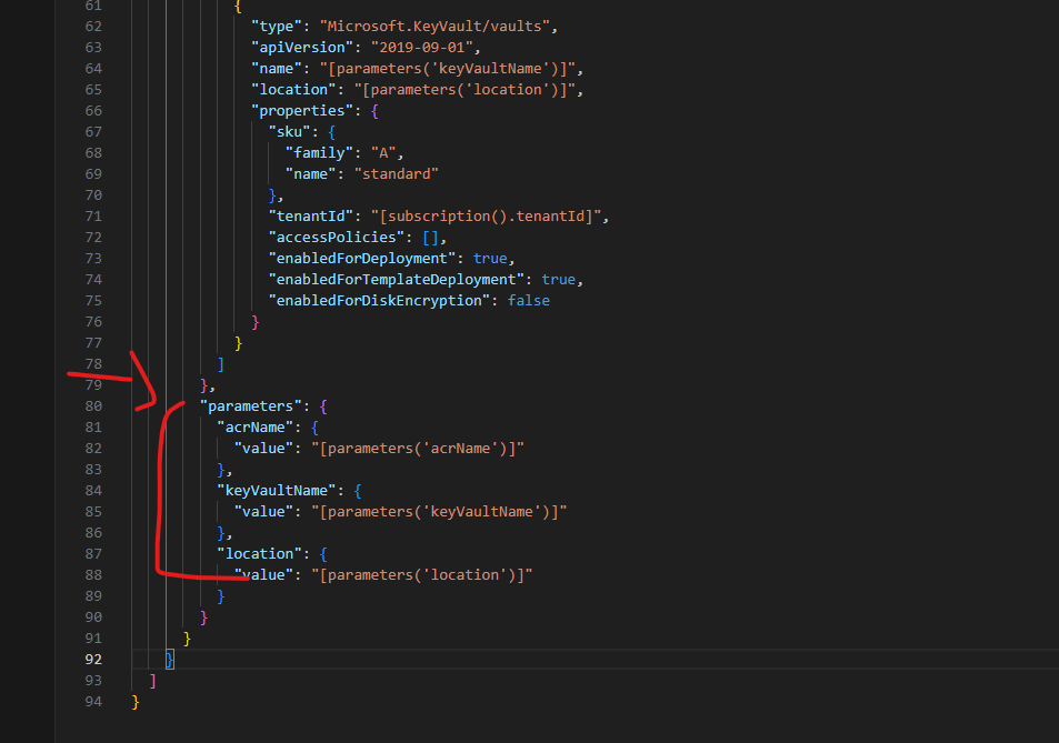

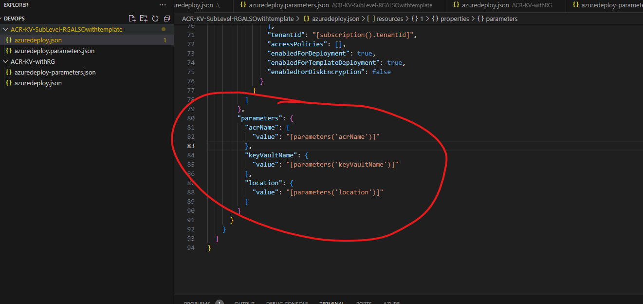

        "parameters": {
          "acrName": {
            "value": "[parameters('acrName')]"
          "keyVaultName": {
            "value": "[parameters('keyVaultName')]"
          "location": {
            "value": "[parameters('location')]"

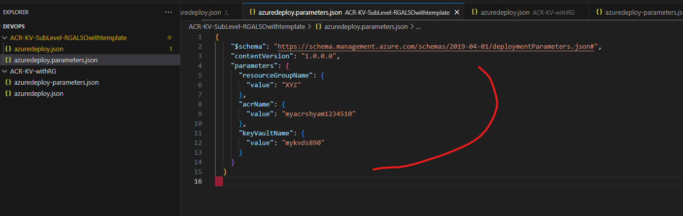

and below is the param file:
  "$schema": "https://schema.management.azure.com/schemas/2019-04-01/deploymentParameters.json#",
  "contentVersion": "1.0.0.0",
  "parameters": {
    "resourceGroupName": {
      "value": "DRG"
    "location": {
      "value": "eastus"
    "acrName": {
      "value": "myacrshyam12345"
    "keyVaultName": {
      "value": "mykv890"
I am seeing following error :

    And also identified that you are trying to create a RG inside another resource group, which is incorrect. Microsoft.Resources/resourceGroups
    For your ease of reference, please use below template
      "$schema": "https://schema.management.azure.com/schemas/2019-08-01/subscriptionDeploymentTemplate.json#",
      "parameters": {
          "type": "string"
        "location": {
          "type": "string"
        "acrName": {
          "type": "string"
        "keyVaultName": {
          "type": "string"
      "resources": [
          "type": "Microsoft.Resources/deployments",
          "apiVersion": "2021-04-01",
          "name": "nestedDeployment",
          "resourceGroup": "[parameters('resourceGroupName')]",
          "dependsOn": [],
          "properties": {
            "mode": "Incremental",
            "template": {
              "$schema": "https://schema.management.azure.com/schemas/2019-04-01/deploymentTemplate.json#",
              "parameters": {
                "acrName": {
                  "type": "string"
                "keyVaultName": {
                  "type": "string"
                "location": {
                  "type": "string"
              "resources": [
                  "type": "Microsoft.ContainerRegistry/registries",
                  "apiVersion": "2019-05-01",
                  "name": "[parameters('acrName')]",
                  "location": "[parameters('location')]",
                  "sku": {
                    "name": "Standard"
                  "properties": {}
                  "type": "Microsoft.KeyVault/vaults",
                  "apiVersion": "2019-09-01",
                  "name": "[parameters('keyVaultName')]",
                  "properties": {
                    "sku": {
                      "family": "A",
                      "name": "standard"
                    "tenantId": "[subscription().tenantId]",
                    "accessPolicies": [],
                    "enabledForDeployment": true,
                    "enabledForTemplateDeployment": true,
                    "enabledForDiskEncryption": false
            "parameters": {
              "acrName": {
              "keyVaultName": {
              "location": {
    Please try and let us know the results. If the provided answer helps your query, please click Upvote it.
