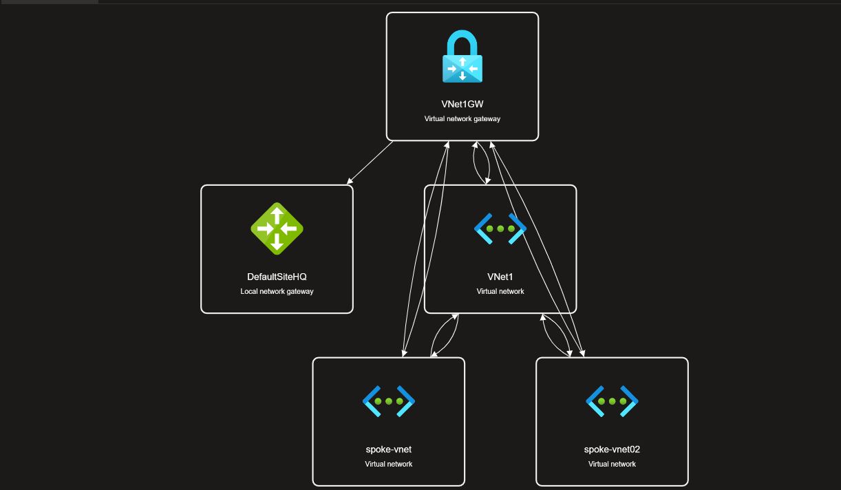

    This my Topology

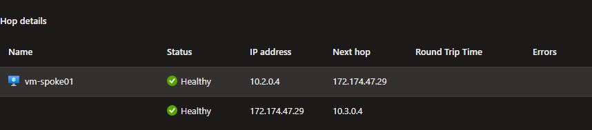

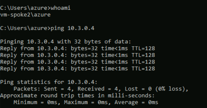

    I deployed two VMs in the two spoke VNets. See this screenshot; they are communicating with each other.
    See this traffic is going like this:
    spoke01vnet----->VPN Gateway------>spoke02vnet
