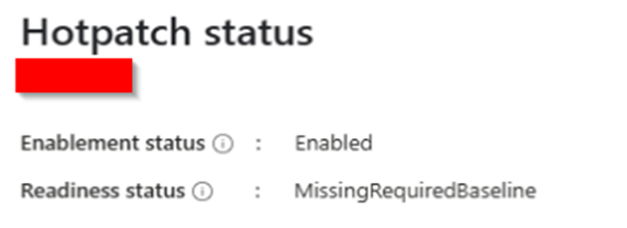

Also, now I see MissingRequiredBaseline state for hotpatch status for this VM too after this job ran!
Is it safe to ignore this hotpatch status?

  1. In one of our VMs, we manually installed the required baseline update and rebooted it.
  2. However, after doing this, the Azure Portal shows a MissingRequiredBaseline warning.
  1. We are concerned that this might mean the VM is no longer eligible to receive future hotpatch updates. Is that correct?
  2. In one of our other VMs, we manually installed all the pending updates including baseline and performed a reboot, but that VM also went into a MissingRequiredBaseline state.
We are waiting to see if the next auto patch job will clear this warning and restore normal hotpatch readiness?

    The MissingRequiredBaseline does not clear just because an Azure Safe Deployment job ran.
    It only clears when a new baseline Cumulative Update is actually installed by Azure during that orchestration cycle.
    In your case, the Safe Deployment job ran at 4/22/2025, 23:51 CST but it did not install any updates (0 out of 2 updates installed). Therefore, no change was made to the Hotpatch baseline state. Hence, the MissingRequiredBaseline persists.
    enter image description here
    Why this happens?
    Ans- Azure Hot patch depends on recognized metadata from the Azure Update Manager flow to validate that the baseline CU was applied during orchestration. Even if the CU (KB5055526) is technically present on the system, azure may not update readiness if the CU was installed before the orchestration window, or the CU was manually installed or the CU was not applied during the specific Safe Deployment job.
    What to do?
    Ans- There is no manual fix required. The warning will typically clear during the next orchestration cycle that installs a new applicable baseline CU. Until then, the VM remains eligible for updates, but hot patching is deferred due to missing baseline validation.
