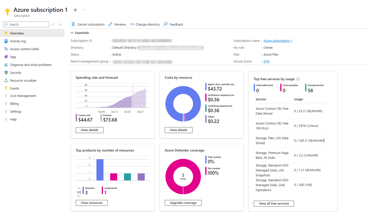

Ive upgraded the subscription and tried purchasing several domains from azure. They are unable to deploy due to subscrition error.

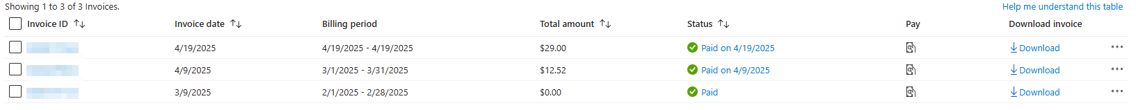

    Check if you have any pending payment due or due date past on that subscription. You can follow this article to check invoice: View and download your Microsoft Azure invoice
