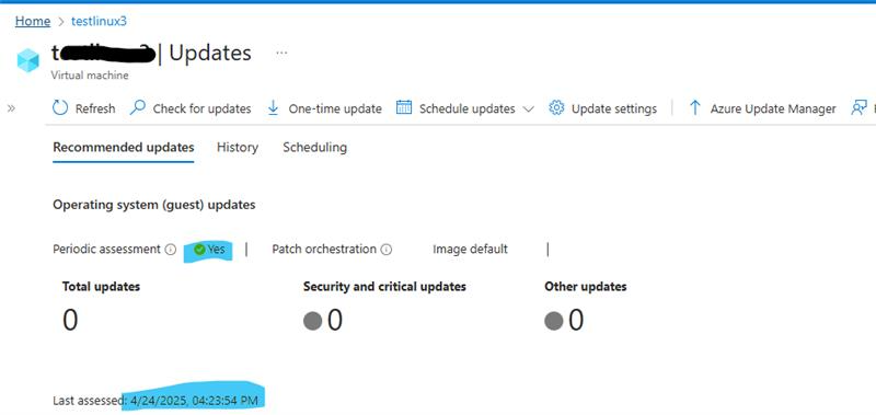

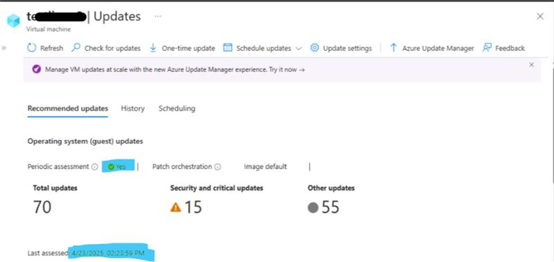

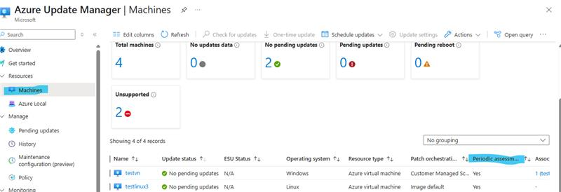

2025-04-24T12:02:16.0133333+00:00 Hello Anant Bera,
To maintain update compliance and verify everything is functioning as expected with Azure Update Manager, we suggest the following best practices:
Enable Periodic Assessment in Update Manager
- Make sure the Periodic Assessment is enabled in Azure Update Manager.
- This ensures your machines are regularly scanned for missing updates and eligible updates are deployed automatically during the scheduled maintenance window.
Monitor the History Page for Any Errors
- Navigate to the "History" tab in Update Manager (via Azure Portal).
- Review past update deployments and check for any failures or skipped updates during the scheduled maintenance periods.
Verify Installed Updates Using PowerShell:
For added confirmation, you can check directly on the VM whether updates have been installed using:
Get-HotFix
