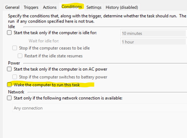

    Your pc might be going into sleep mode.

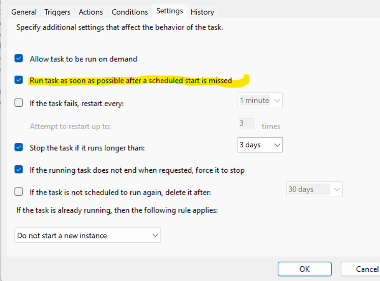

    Enable this setting.

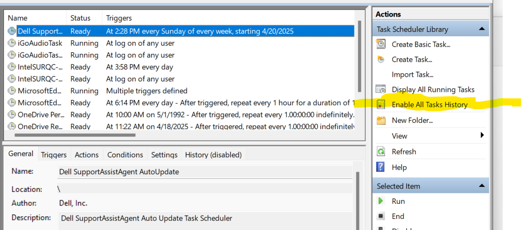

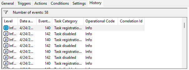

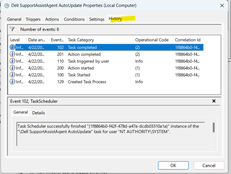

    Also enable task history.
    Then you can select each tasks history tab to see what the task scheduler does with the task.

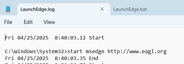

    For testing this issue, I added logging to the scheduled task. I built a .bat file to launch a browser and saved in my C:\Scripts folder.
    @echo %date% %time% Start
    start msedge http://www.eagl.org
    @echo %date% %time% End
    I configured the task to run cmd.exe with these arguments.
    /c c:\Scripts\LaunchEdge.bat 1 >> c:\Scripts\LaunchEdge.log 2>&1

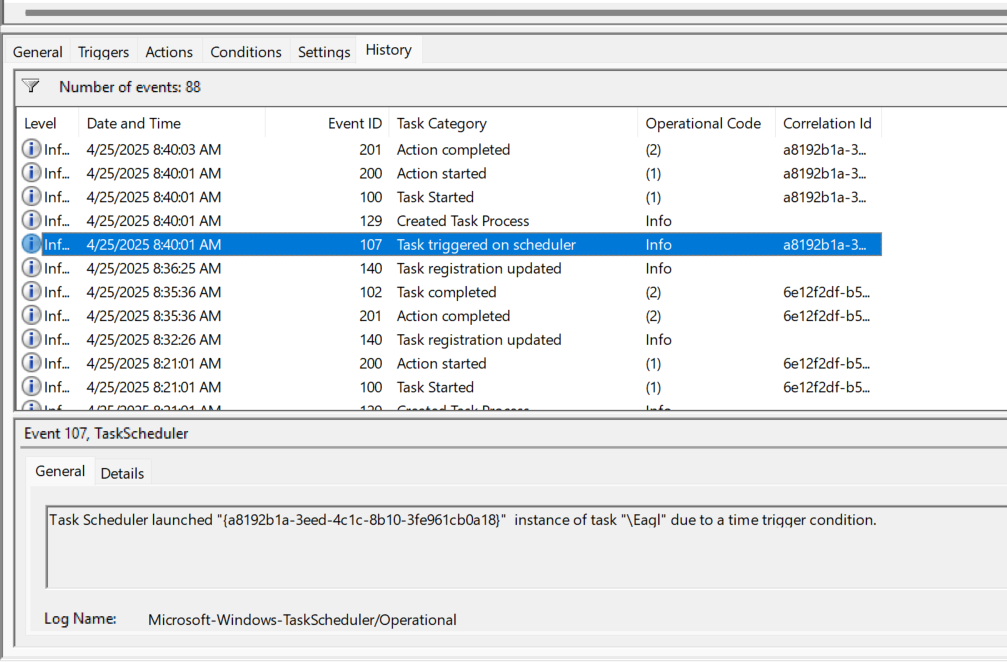

    I set the task to run at 8:40am and I locked my pc.
    When I subsequently unlocked my pc I saw that the task scheduler launched it at 8:40 and I saw that the tab was opened.

    In the log file I see the timestamps.

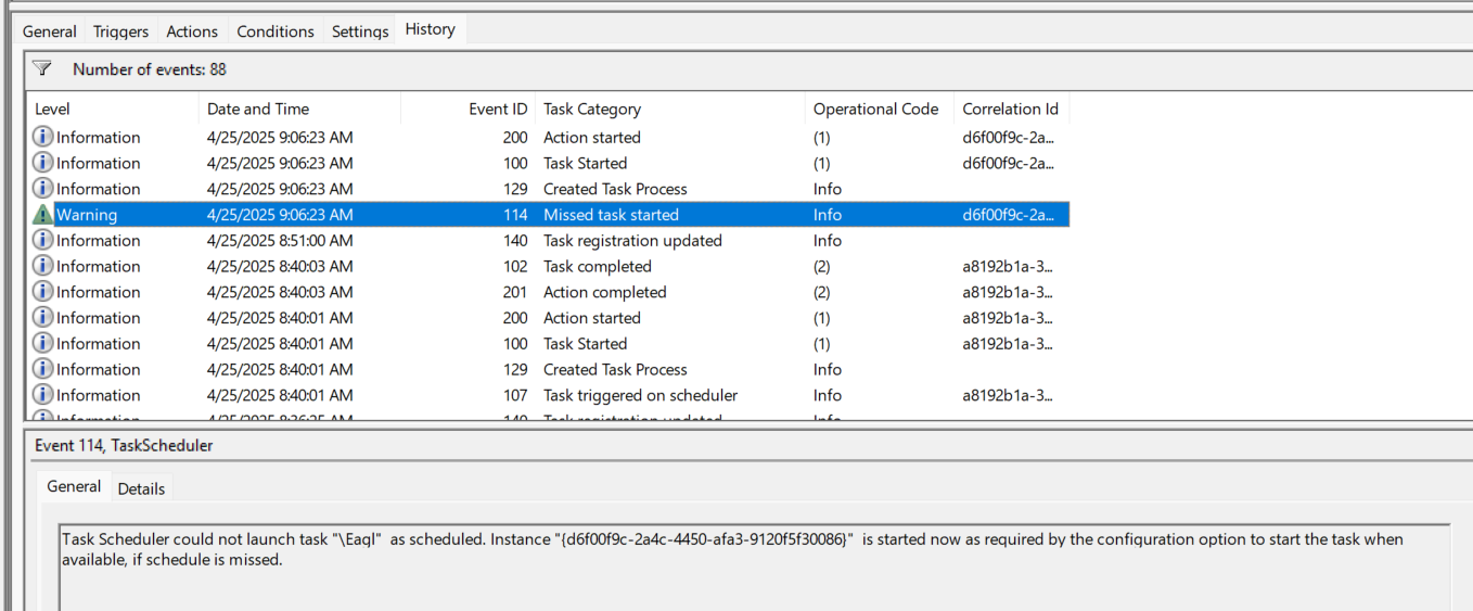

    Next I set the task to run at 8:55. This time I closed the lid on my laptop. I have configured my pc to hibernate when I do that.
    I opened it back up at 9:00am.
    But it took 6 minutes for the task scheduler to recognize that the launch was missed. That was recorded in the history and the log file.
    Screenshot 2025-04-25 100648

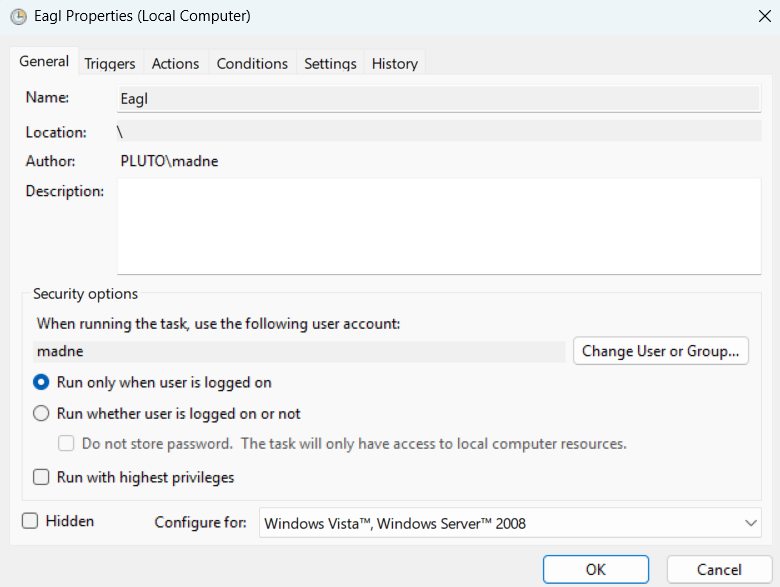

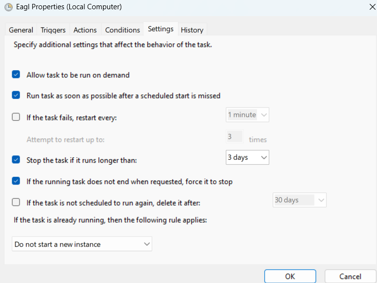

    Here is how I configured the task. Note that I do not have Run with highest privileges checked.
    Screenshot 2025-04-25 101821
    Screenshot 2025-04-25 101839
    Screenshot 2025-04-25 101857
    I would suggest that you review the settings and implement logging so that you easily see if the task is being launched and when.
