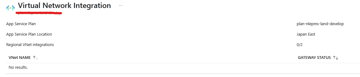

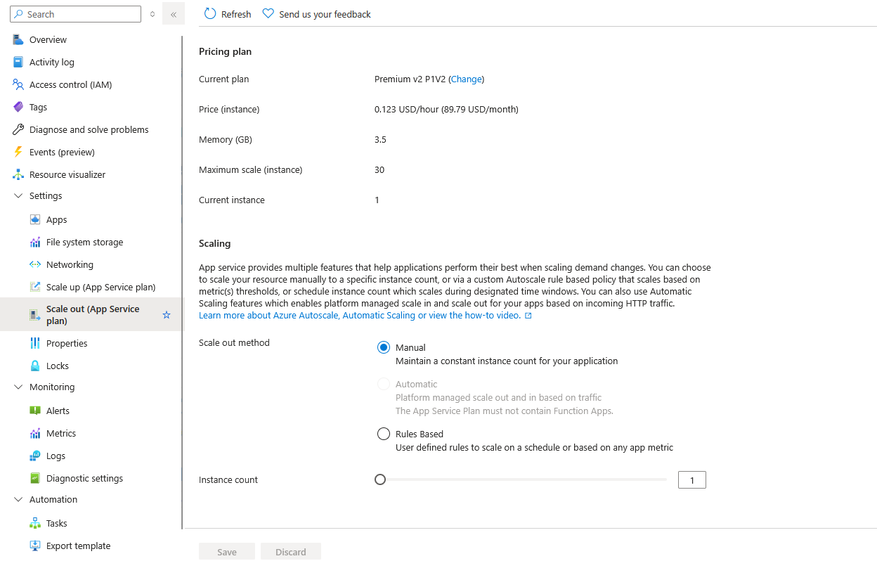

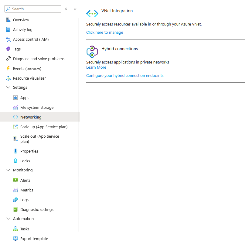

Below image is our current App Service Plan:

    The “Manual” scale-out method is selected because Azure Functions are hosted under the App Service Plan, and automatic scaling is not supported in this setup. Since you're not relying on autoscaling or high throughput right now, maintaining manual scale with 1 instance is perfectly fine. Microsoft Docs – Scale App Service Plan
    Thanks for checking the VNet tab. Since you see “No results” under Virtual Network Integration, this means your App Service is not connected to any VNet currently. That gives you additional flexibility in downgrading without worrying about breaking any private network dependencies.

    -I forgot to inform you regarding our current plan metrics:
    -Current plan is premium with 3.5 GB memory and the metrics shows a high usage of memory. Since Basic B1 only has 1.75 GB of memory it looks like I will hit some problems by downgrading what do you think?
    -Additionally, if I stop all the web app and function app will the memory and other metrics go down?
