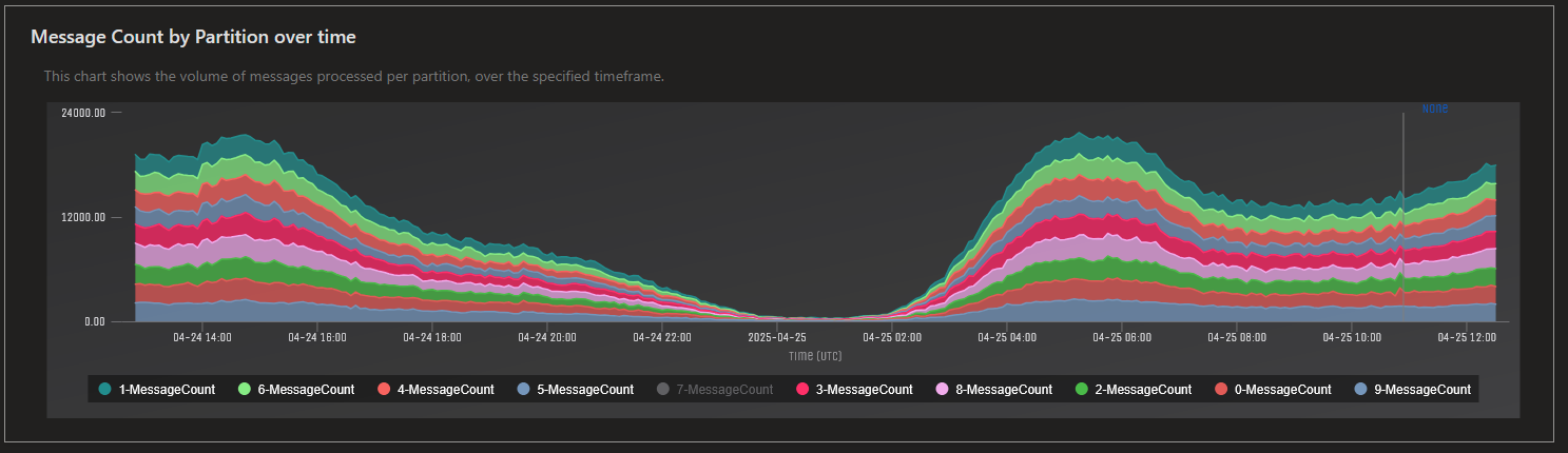

One of our Azure Functions is having issues all of a sudden to read from partition 7 of our Azure Event Hub, the same issue was seen about 3 months ago but the support team could not find anything so I recreated the function and Event Hub. This seems to have fixed the issue for a while but as said the issue has come up again. It is always the same partition that has the issue just as last time, just a different partition from last time. This is what I can find in the "Diagnose and solve problems" blade and "Event Hubs Trigger Issue Analysis" option:
While the other partitions all look great:
Our traffic is very predictable and i have checked that all partitions have about the same amount of messages going in to them.
